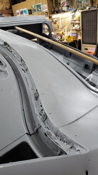

Ordered the rear filler (Duchman) panel and found a big difference in the depth of the widow channel. The replacement panel is from Goodmark. I also see that the AMD panel looks to be made at the same location from the stickers on the panel. Has anyone come across this issue? Looks like I will need to mock fit glass and trim before finish.
The trunk lip area is also shy. Any help / Ideas would be great .... Thanks
AMD or Goodmark, make certain to test fit your glass and more importantly stainless trim before committing to body and paint.
whatever you don't mock up will bite you in the *** after paint
Almost all restoration panels need to be reworked here and there. Spend the time working the new panel to the best it can be. It’ll save you headache and aggravation later on.
Don’t let it get you down- it’s still better than not being able to get the part at all!
