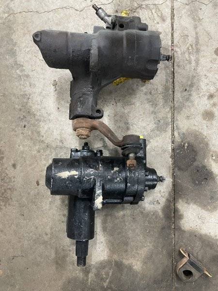

Just a warning. Classic Industries, and others, are selling this Cardone power steering gear as a direct replacement.
It does NOT fit my 71 RR. The position of the spline that mates with the steering coupler is more than a half inch shorter than the original. It was visibly short when I took it out of the box.
Test fit today and, even with the coupler fully extended and the steering column as far forward as it will go in the brackets, the coupler will not be far enough on the splines to get the roll pin in.
Classic is already sending me a return authorization but I wanted to test fit just to make sure. Glad I did. The price was right but it was too good to be true.

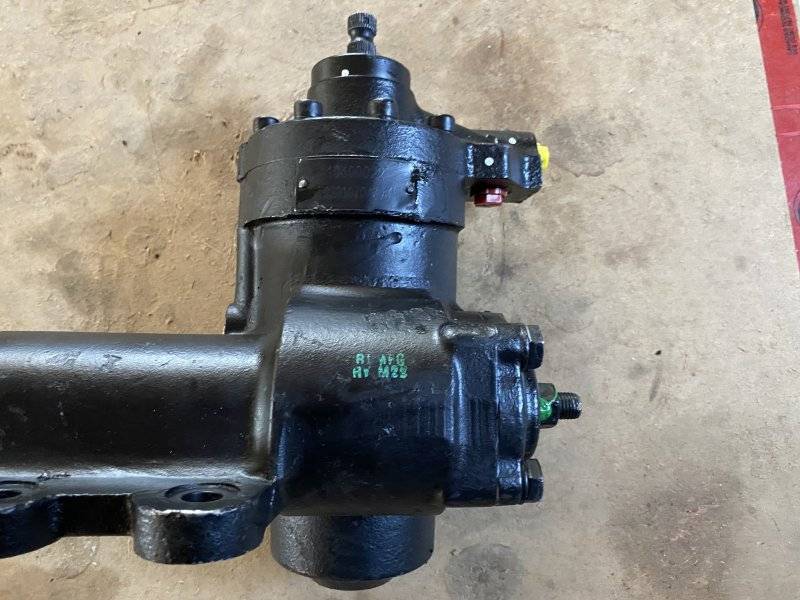

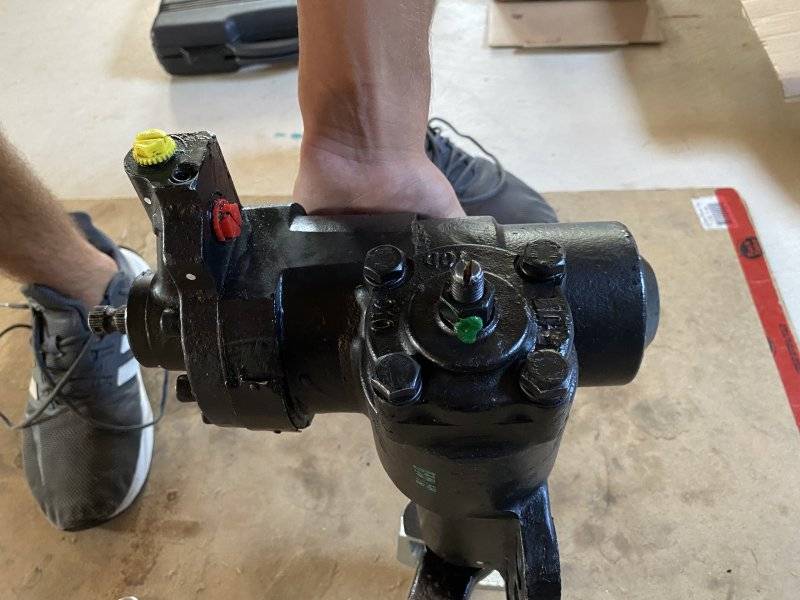

Experienced the exact same, but from Carid. My mistake was not realizing it was the wrong part till 6 months later. Didn't have my original gear box to compare to the unit received and purported to be the proper replacement, as I hadn't gotten around to pulling mine out of my car. Their photo of the part on their website is the correct gear, but the one they sent me is different. They can't even tell me which gear it is from photos I sent them. Is anyone able to identify this gear?
