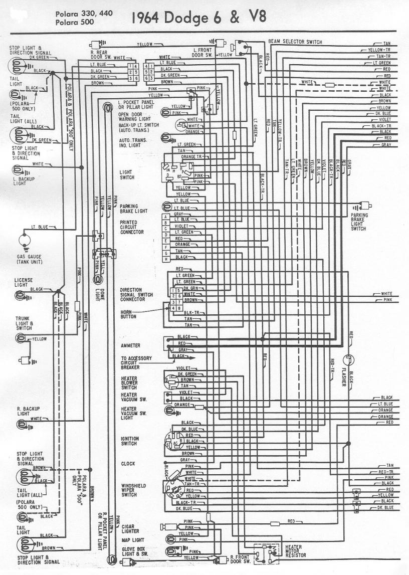

So-o-o-o...now it's time to deal with electrical issues on the '64 Sport Fury. First;how the bleep does one get the knob on the headlight/dimmer switch off? After that;does the black ring unscrew from the switch? I've got working headlights,but not marker lamps,backup lights,brake lights or taillights when the switch is pulled to the "on" position. My turn signals work in the back,but not the front. The interior lights come on when I step on the brake pedal.:rolling::rolling::rolling: WTF!!!!!!!!!!!:confused::confused::confused: I've got new switches;getting the old ones off is proving to be troublesome. Any advice is appreciated!!!!!

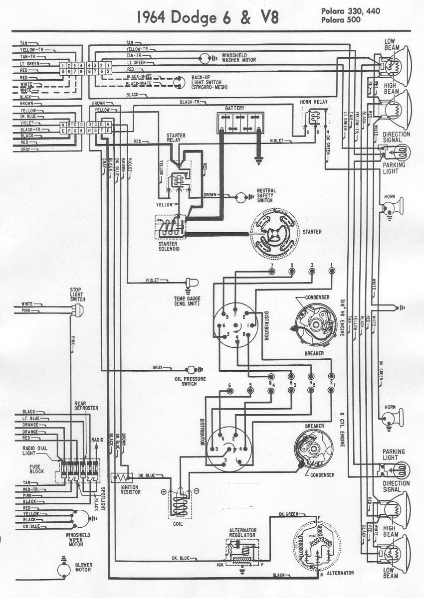

Hey Al, here are a couple wiring diagrams. It sounds like you have the wires at the steering coulmn connector mixed up.
I forget the exact details but the headlight switch knob pulls out with the shaft in place, then you unscrew the ring on the dash side.
HitIt;thanks! I bought one of those large-size color-coded laminated diagrams a while back;I recommend that to anyone doing an old ride. This car sat in storage for many years,but no evidence of Mickey and Minnie and the kids taking up residence under the dash.:no: The wires look good,condition-wise.
I told you guys that I was going to request help with the electrics. I'm beginning to understand why electricians consider themselves superior to the rest of us wrench-throwing garage apes.:grin: So,I won't make any disparaging remarks about electricians:no:.
