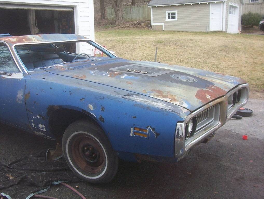

I have a 71 charger and I need a roof skin I have axcess to a roof skin from a 73 charger question is can I use it thanks any info will help thanks guys

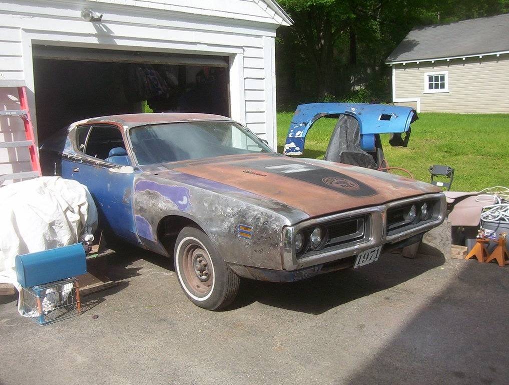

I did one on my 71 and used a skin from a 72 and it fit excellent
Any 71/74 2 doors B body ( Dodge or Plymouth ) will fit. All use same skin
