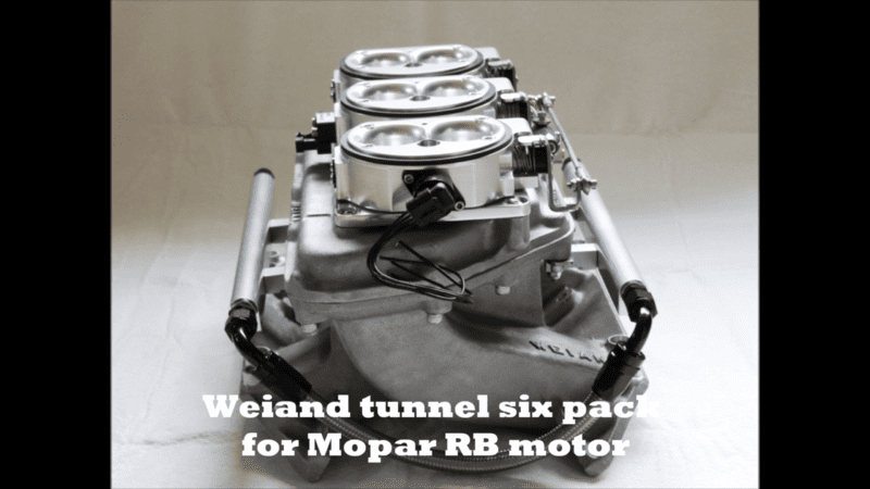

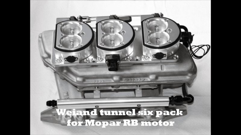

Then I will discuss the details with their shop engineers, and see what comes of that. I'll know if that Weiand 6bbl intake fits under my hood soon as it arrives this week :bananadance:
If it fits, I would like to use it for the stroker build, using my Promax modded Holley carbs to start out.
Later, if I can, I may go this route w/the Weiand:
