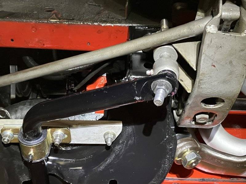

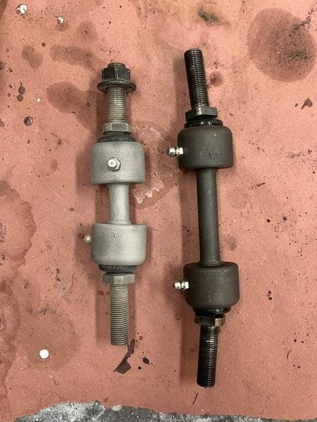

I modified these:
Moog, purchased through Rock Auto. Ball jointed so no bushings to wear out. Add grease to the ZERKs though.

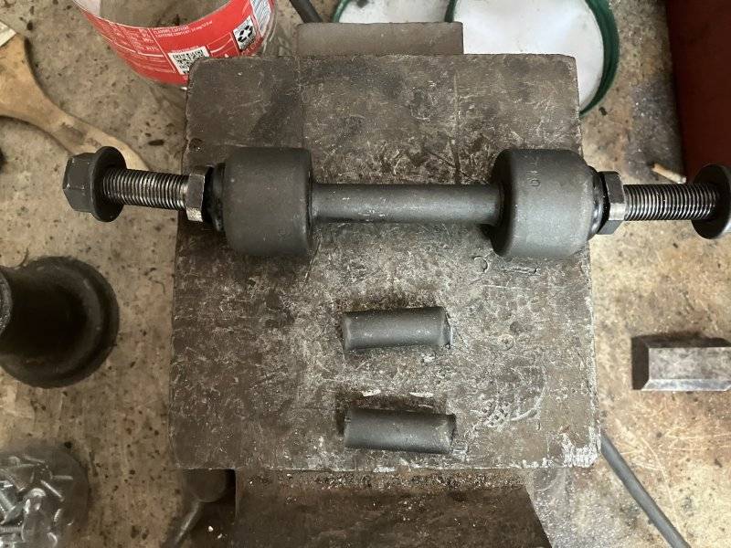

They were a bit too long so I cut about 1 1/2" out of the middle.
Welded back together, sand blasted and ready to go.
