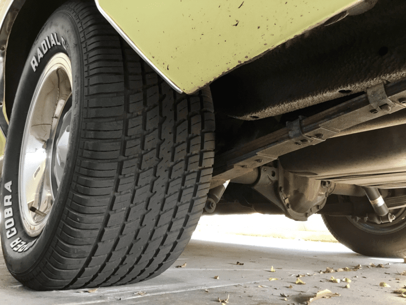

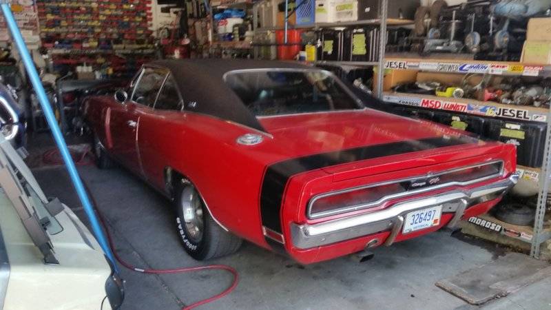

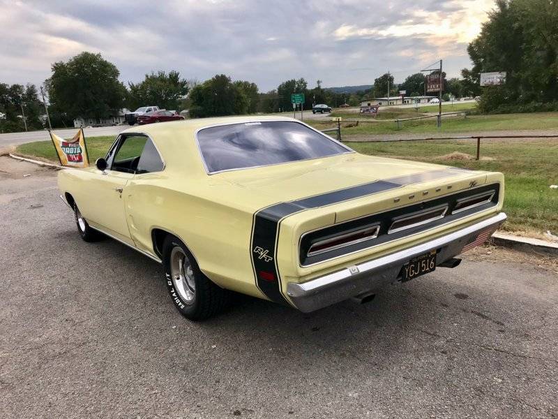

What is the wheel and tire size shown in this photo? Also the backspacing? They both look very wide in the photo.
8” wide rim. 15”dia. 295 50 15 Cooper Cobra.
Same size on the back of my Charger. I like the fat sidewall look of 295's but not all jacked up like a 275/60's makes it look.
When pushed HARD on Track day, the inside wall kissed the leaf spring. A spacer on that side only solved that.
Hmmm, mine have never rubbed anywhere before and I have hundreds of passes at the track on this car.
So you two guys are running 295/50/15 on 15x8 Rallye wheels on the rear. Is the backspacing 4.5"? What size trim rings do you guys have on your wheels? Are they the 15x7 3 step? Do you have the "gap" between the ring and the wheel?
How about up front, what size tire and rim?
Yes, 4-1/2" b.s. on the rear with the 8" wheels. I still run the 7" trim ring and there is a gap but I have never had any comment or even notice. 245/60's up front on a stock 7" wheels.
