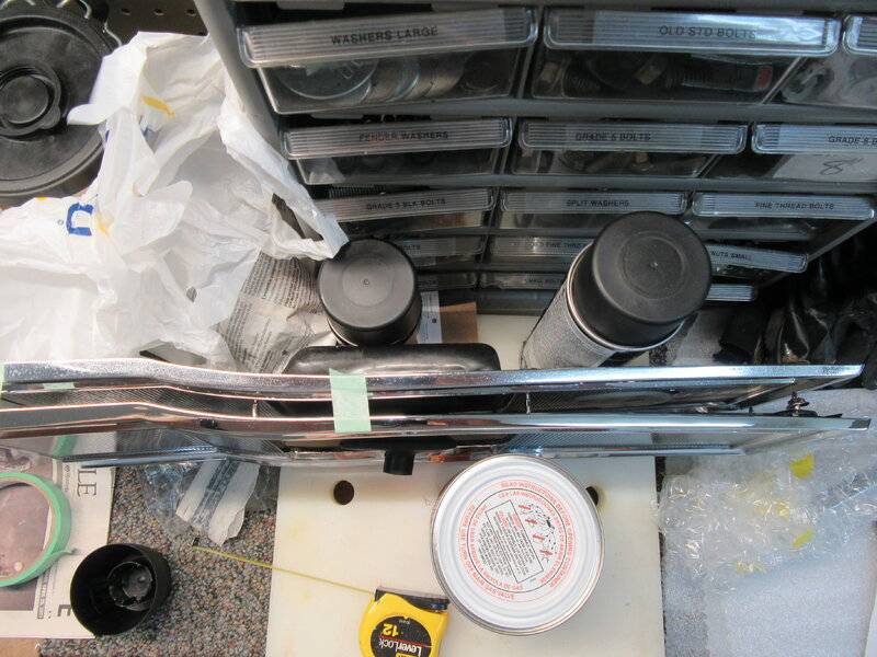

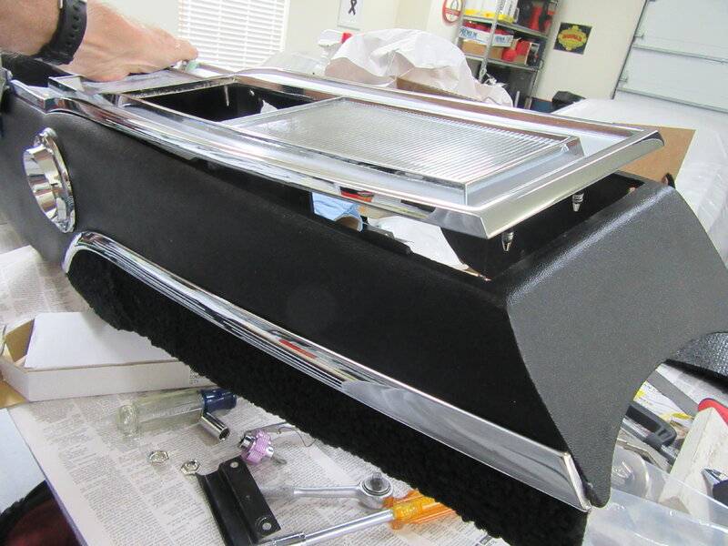

Ordered a ribbed console set and although the door remains on backorder I started fitting the rest of it to my car's console. Ran into a problem with the front top plate (manual trans) in that it does not conform to the top profile of the console base (which is original). Basically it's sprung compared to the original. If I hold the rear down tight to the console base, the front is sticking nearly 1/2" up in the air and impossible to install properly.

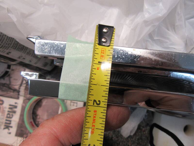

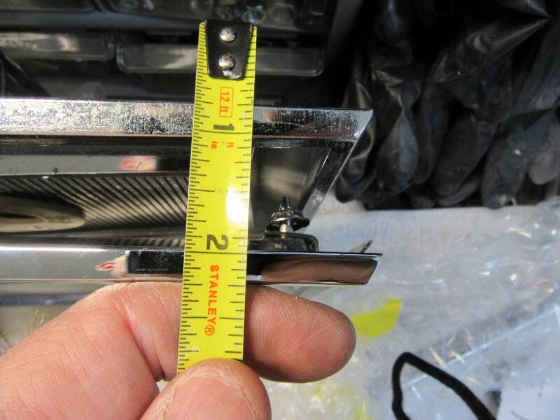

Another picture. Actual warp is around an inch from this approach.

No, they are not cheap. I’ll let you know what Classic has to say about it. Looking down the side of the plate it’s clear it has a swoop cast in it. I have a feeling I will have to ship the whole kit back to them for a credit. I’ll probably try PG Classic then if the confirm they are not from the same source as OER.
They're ejecting them from the mould before they get a chance to set or different thicknesses are shrinking at different rates warping it. Something like that should have a "clamp table" to cool on and hold it flat. But I digress..... that sucks that it's that way after good money spent.

Fran - no, I’m unable to use it. The console body is way to stiff to deal with that much warp and would look weird and probably gap off of the transmission tunnel at the front if it could be forced together. The old top lays nice and flat on it.
