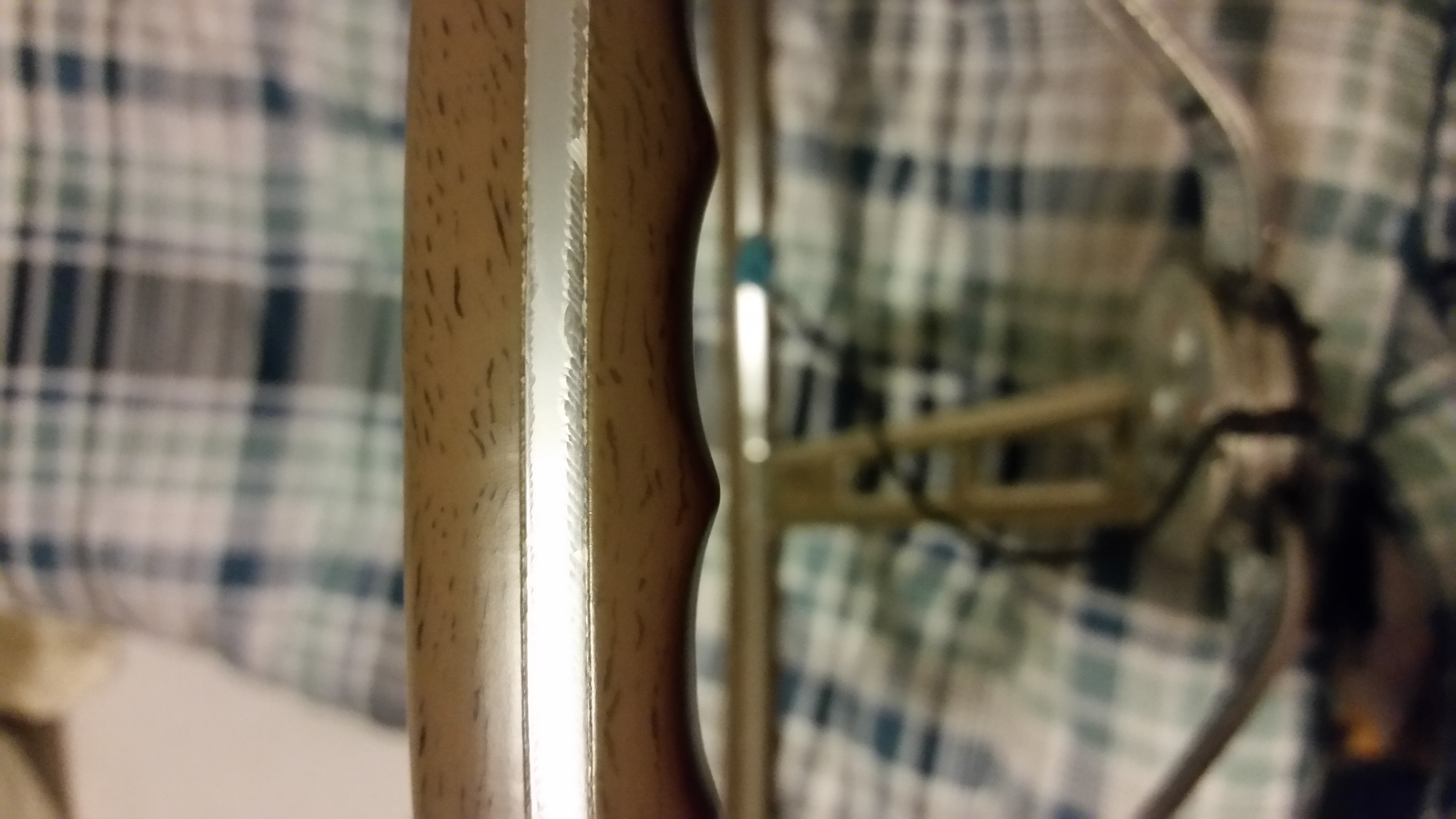

For those who are considering making this purchase. Don't.

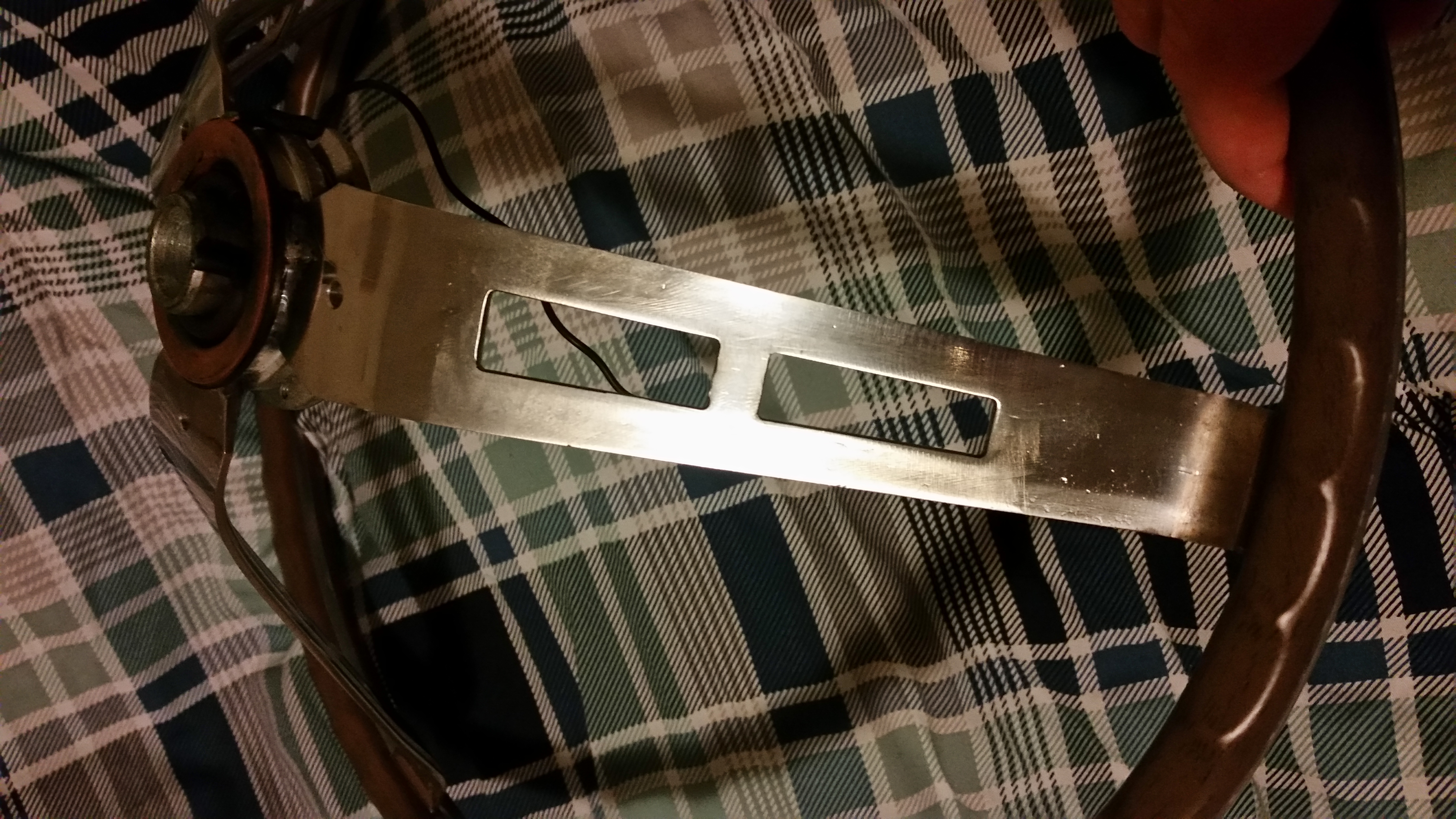

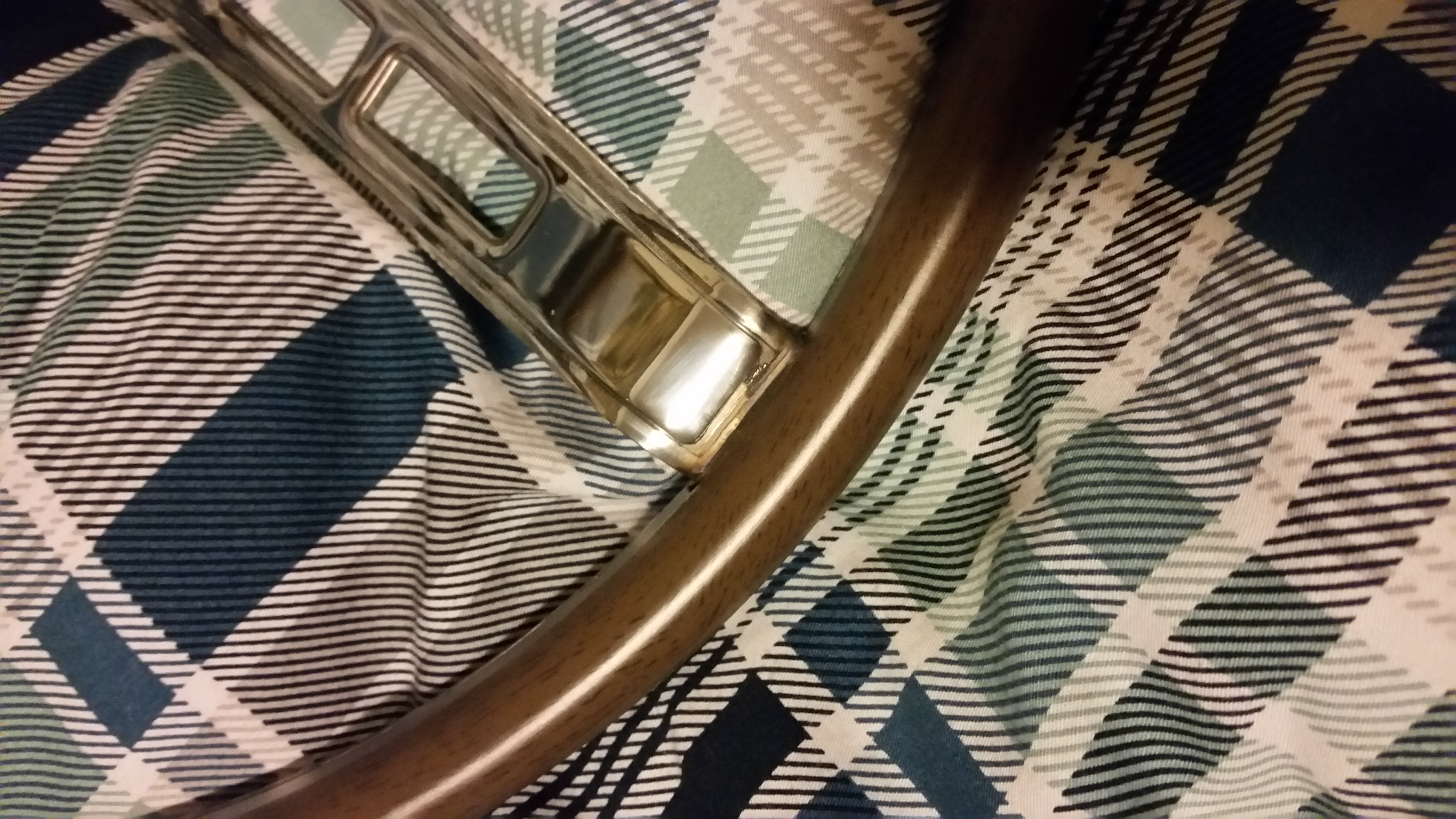

I could get over the polished spokes, in time, so I made the plunge. What a horrible pos. Made in China label was the first thing visible after unboxing. From there it proceed to get worse. Woodgrain has no texture, spokes are unfinished on the back and the trim ring is rough.
I expected more for my money. I suppose I shouldn't. The biggest joke is the OER tape used to seal the box!

So, after waiting and hearing nothing from the vendor regarding my complaint I figured I had nothing to lose. I ended up brushing the spokes quite simply using WD-40 and a red Scotch Brite pad. What a great finish.
All is not lost. I still do not recommend the purchase but it is certainly a salvageable piece.

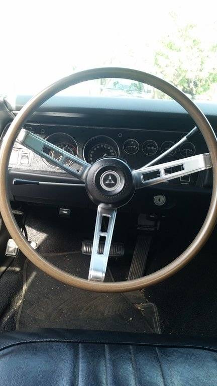

Finally slowed down long enough to take a picture!

The "brushed" look that I applied using WD40 certainly passes my scrutiny and the spokes look far better than they did.
