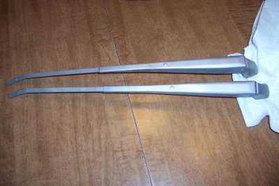

They have a bead blasted look so I bead blasted mine and they look stock.
Here's mine - polished on the left and stock on the right.
did you refinish them after bead blasting?
I really had just finished bead blasting them and am trying to figure out what kind of finish. Probably satin clear.
Being that they are stainless steel, you can go either way...polished or matte finish.
- If you wish them to be matte, just use scotch brite/ steel wool/ or 1,000 grit (or above) sand paper.
- If you wish them to be polished (like chrome) put a 4" buffing wheel on your stationary grinder, load up the wheel with some 'White' ruche (sp?), (stick type polishing compound) and go to town. I did all my window trim and wiper blades on my `66 Belvedere II. With the sedate paint color they really help the car to 'pop'.
Yeah - mine will be mostly a show car - if it is a huge problem I'll just have them bead blasted and matte clear
