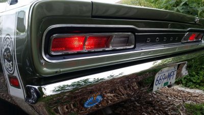

Anybody know the best way to restore the tail light lenses on my 66 satellite? I was thinking of sanding then spraying them with a clear coat 2x.....any inputs? Ideas?
Are they just hazy, or are there chips and cracks? If you sand with finer and finer paper, up to 1500 grit or so, then use plastic polish, they'll sparkle like new. But caution must be used when sanding near raised lettering, ridges or any other details that shouldn't be obscured. Doing this will look better and more authentic than spraying with clear coat, plus there's no risk of flaking later on.
Tiny chips, cracks or missing bits can be filled with coloured acrylic resin, but the effort involved is usually reserved for hard to get parts.
http://www.meguiars.com/en/marine/products/m1008-clear-plastic-polish/
http://www.meguiars.com/en/automotive/products/g12310-plastx-clear-plastic-cleaner-polish/
PlastX all the way. Used it on my Super Bee lenses and they turned out great.
Take your time! I completely removed, disassembled then washed and dried my lenses before polishing them. Twice.
Took about two or three hours to do both but I also re-sprayed the argent and used Autosol and wire wool on the chrome.
You can also buff them, but you must be very CAREFULL and use a loose cotton buff wheel with green or whit rouge.
