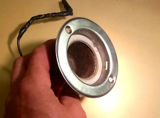

Here they are - pretty typical rust.
![image.jpg image.jpg](https://www.forbbodiesonly.com/moparforum/data/attachments/99/99991-6e32c304c59ee600eea8b0e74d7da727.jpg)

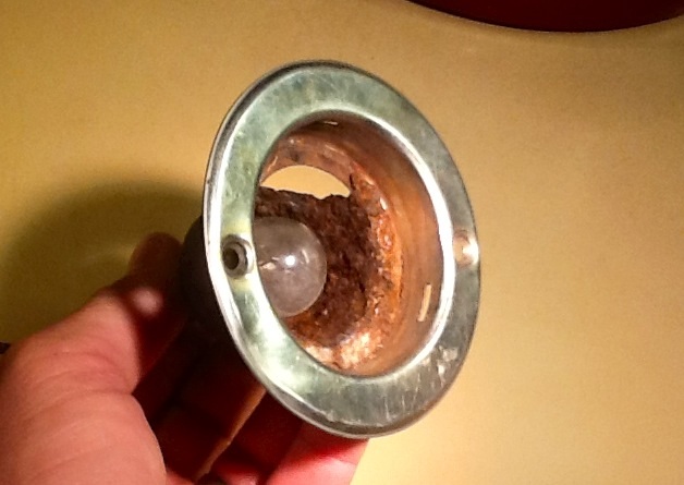

This one is rusted pretty good, but still in one piece.

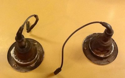

This one is in pretty rough shape.

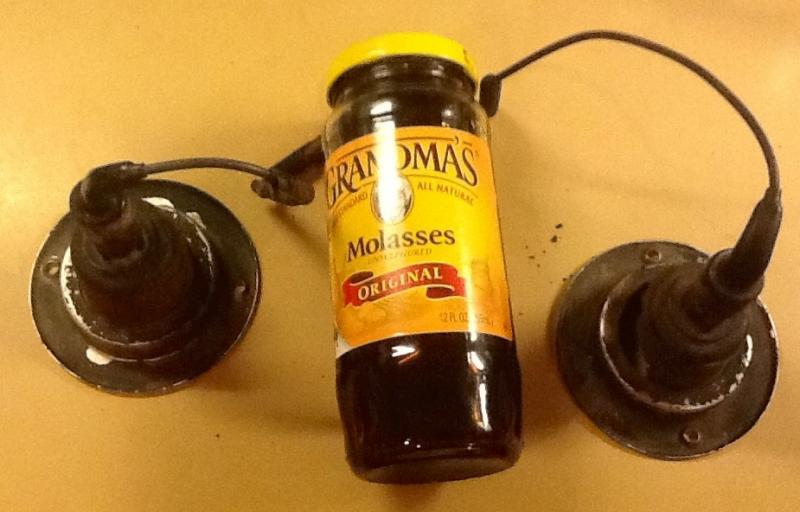

Here we have our derusting solution, Grandma's Molasses (had some on hand).

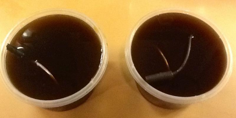

And they're off to sit on the workbench for a few days before I take another look. Notice that I had to sit them on their sides - this way no air bubbles get trapped up in the housing, preventing the solution from working up in there.
![image.jpg image.jpg](https://www.forbbodiesonly.com/moparforum/data/attachments/99/99992-d8b8e77da11258b2fbaf984ef627efcf.jpg)
Can't wait to see what I have in a day or two. Let's hope they dont disintegrate lol.
