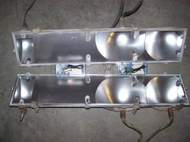

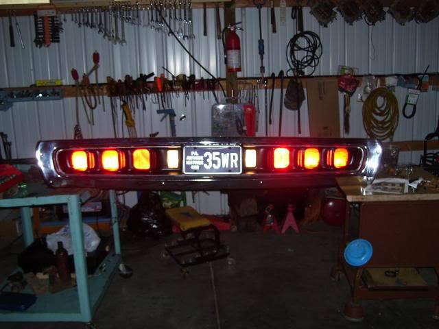

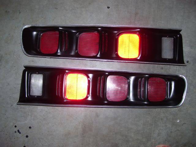

Worked on my taillights a bit. I have the sockets to replace yet.

The four wires, black, brown, purple and green. Purple is reverse, black is running lights and brown and green are left and right brake lights. When troubleshooting the lights out of the car make sure the taillight housing is grounded. Otherwise you will get nothing out of them.

Light sockets are not that hard to change if you have bad sockets.
I used the Dorman sockets, $2.99:
shop.advanceautoparts.com/p/dorman-conduct-tite-electrical-sockets-2-wire-double-contact-3-4-inch-85803/5012112-P?searchTerm=dorman+part+%2385803#
Make sure you clean the metal housing before inserting the new socket.
This is where the socket gets its ground.
When you insert the new light socket hold it in there really tight with one hand and use a flat tip screwdriver to bend the tabs over nice and flat. Once you test the lights and the sockets are working, run a bead of silicone around the new socket where it goes through the housing to give it a water tight seal.

What determines the color of the bezels being black or silver? My white R/T has silver bezels.
I'm not sure. I seen a set that I liked and just painted them like that.
