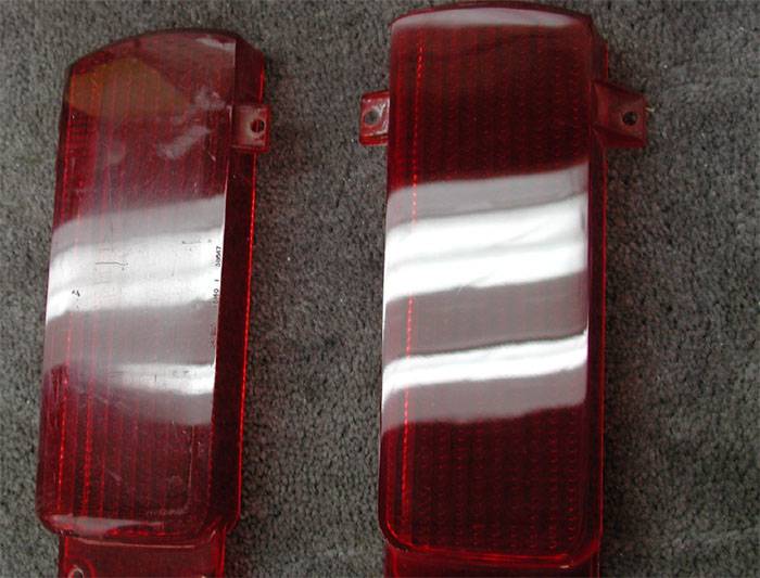

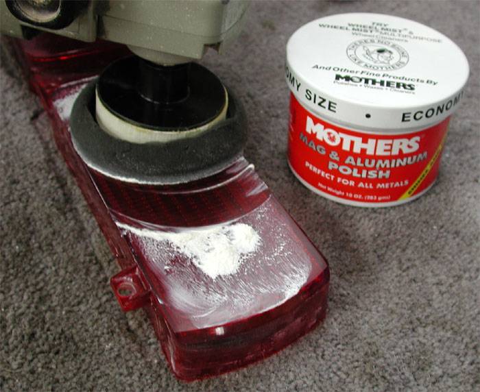

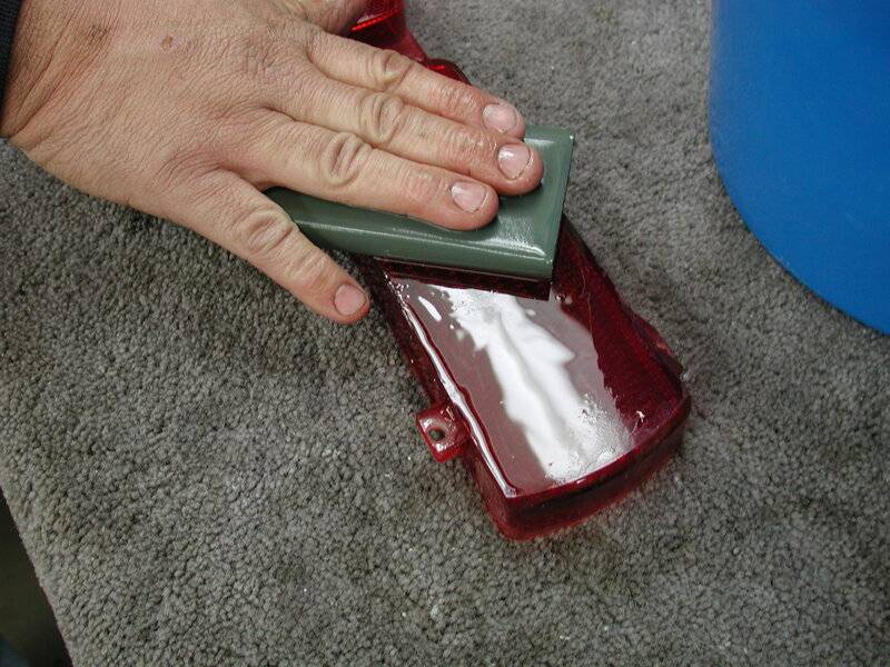

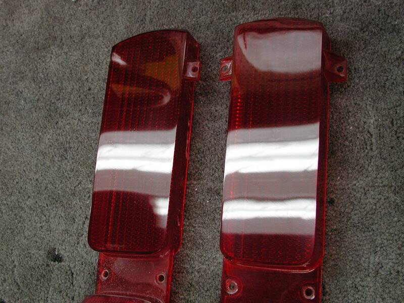

I've tried the Plast-X ... Use the Mothers... It works better & it has other uses... You can use it by hand with a cloth but the foam pad works far better...
I just looked & found my old photos....

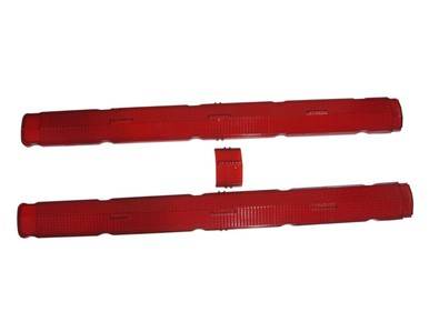

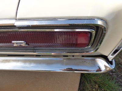

Interesting. Its tail lenses for a 66=67 Charger.
Are those smooth on the exposed surface? Or textured?
If smooth they can be made awesome... Textured, use the Mothers on a cloth & see what you can do... It'll definitely improve what you have...
They are "ribbed"
