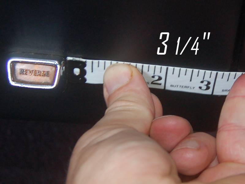

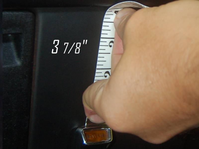

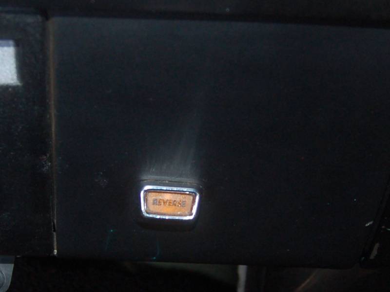

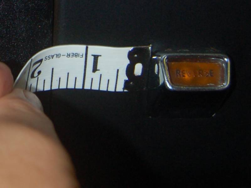

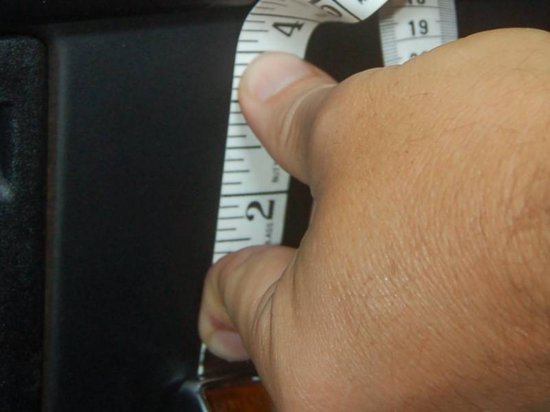

I am in process of getting a TKO 5 speed in my 71 Charger. Just wondering if someone has measurements for the dash mounted reverse indicator location. I have seen photos of it beside the ash tray, just curious on the up and down and side to side measurements? Thanks in advance.

Here are photos that were sent to me.
