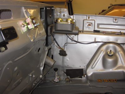

Heres how I did mine . But my engine bay was empty. My ptop valve is on a bracket. As long as the prop valve is between the M/C and the rear brake line you should be good. That's what the guy's at the right stuff told me . Also their stuff is nice the stainless is a little tougher to seal but it can be done. Good luck s1 005.JPG
