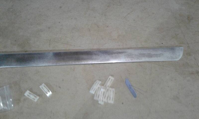

Once I get the rocker panel trim cleaned up, what's the best method to reinstall them on the Coronet?
Any tips? Hook the top and snap the bottom on... or vice versa?
And how do those spring clips orient?
I just took mine off my 69 Charger and the clips mount with the "eyebrows" or the "two fingers" pointing towards the ground and then when installing the moulding the bottom of the moulding slides over the "eyebrows" then pull the moulding up and snap it over the top of the clips.
Well, I don't understand what you mean by "the eyebrows", but thanks for the tip on the bottom to top attachment.
