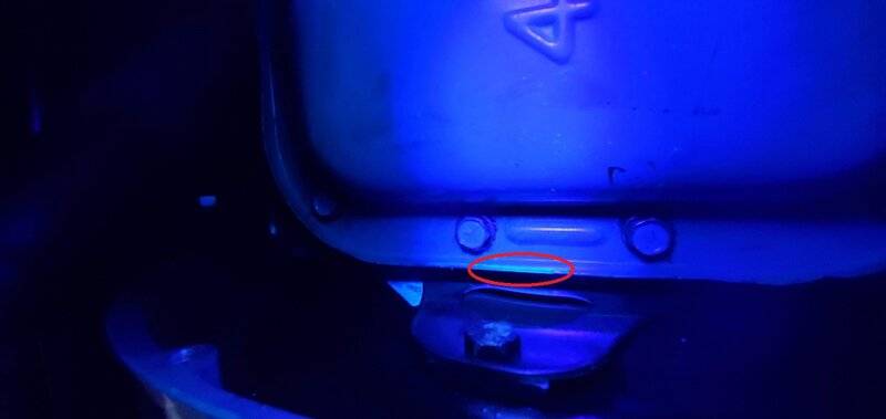

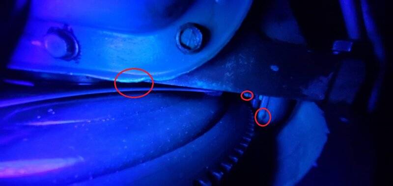

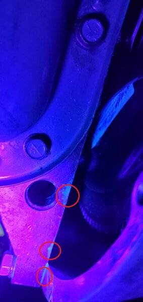

I thought my RMS leak was finally fixed, but was still having oil dripping from the bottom of the transmission housing. I wanted to be sure it wasn't coming from the valve covers/oil sender/rear of the valley pan etc... I added a bottle of UV dye and I found (lots of) oil around the top and bottom of the inspection plate. There was also oil on the starter inside the housing.
Would an RMS leak come from the top of the housing, or would it be from the inside bottom? Or both?

It did look like a murder scene under there! The transmission pan is clearly being sprayed with the fine mist of oil as it leaves the housing while driving.
