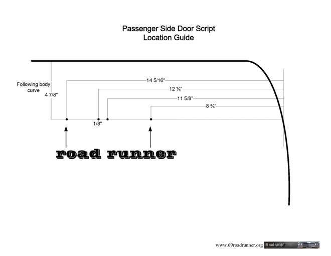

Hey i just bought the road runner door decals but i can't seem to find any pictures of a car with them for me to get an idea... Anyone know or have a picture of where the stickers are suppose to be?

Hi moparstuart,
Would you be able to measure and/or show the location of the "road" and "runne"r emblems for us? I have the adhesive type, and doors from a Satellite without pegs/ holes. You would be providing a great service- there is information on 68's and 70's elsewhere but not for a 69. Thanks for any help.
I'm sure mine isn't correct but i eye balled it and it looks the same as moparstuart's RR. Also where did you find the adhesive ones? I had to cut the pegs off mine and glue them on...
Thanks- I looked but did not see. it was getting late last night. BTW, the emblems were listed on ebay under "road runner emblems". They are original Chrysler and 1/2 the price of YrOne, but still pricey.
