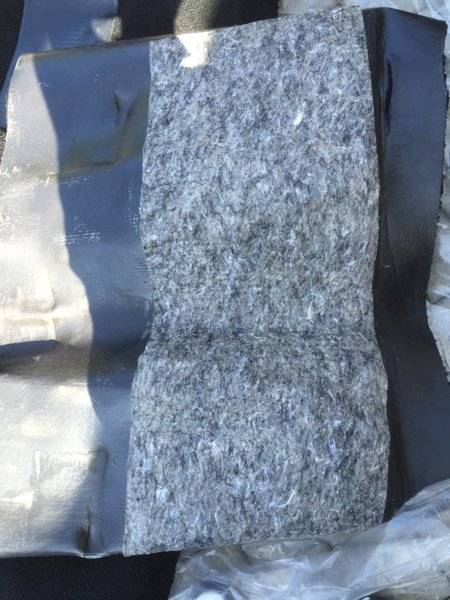

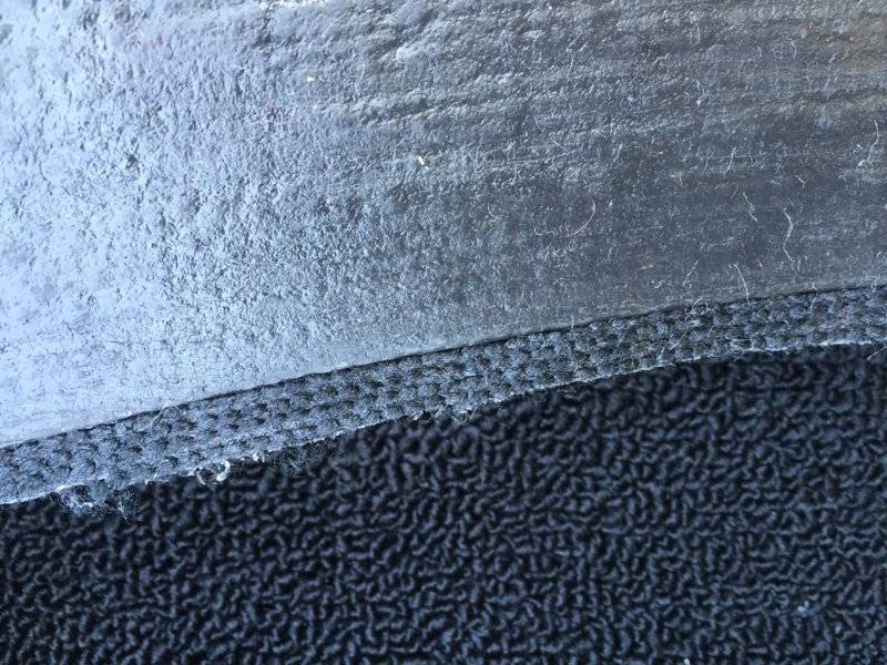

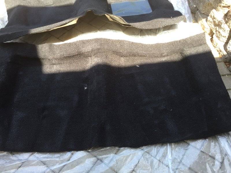

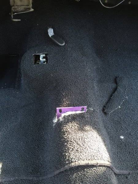

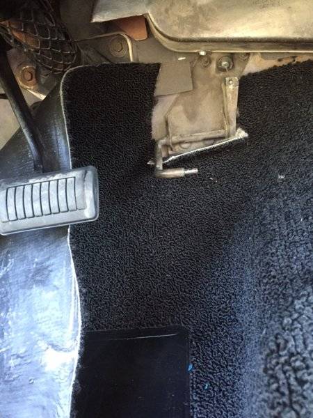

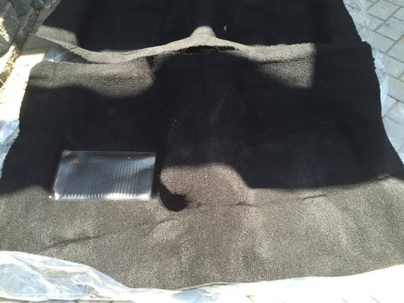

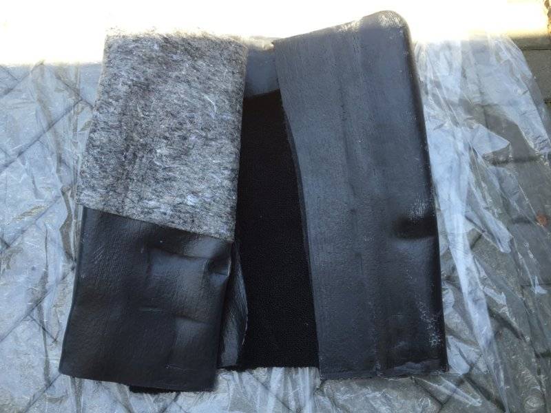

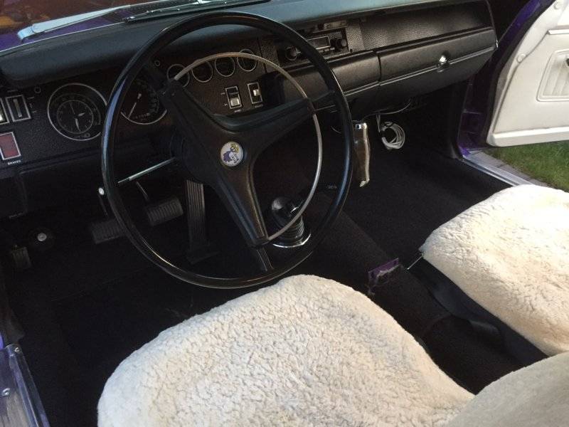

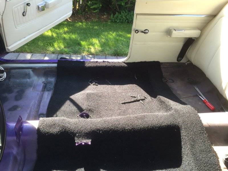

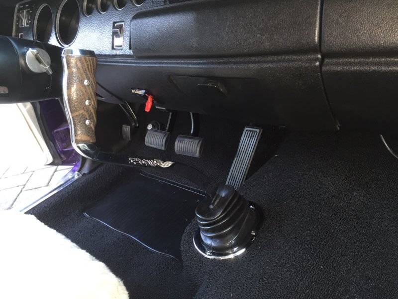

I bought my carpet from Rock Auto a few years ago for my 70 RR. It was shipped directly from ACC which I believe everyone pretty much does. They were the cheapest of anyone on the internet ( you can google a rock auto coupon too). I got the one with the heavy mass backing. I don't like the idea of glueing a backing (eg Dynamat) on all the metal of my car floors. The carpet fit was very good and there was plenty extra to trim easily and go up the firewall. took me and my son about 4 hours to do the install including removing and reinstalling the bucket and rear seats.

nice that is the ticket thanks,coming from a carpet installer nice job.

If you need to cut holes poke something through where you want to cut and cut from the underside. I found this neater, my carpet didn't have jute glued to it.

Once the carpet was fully installed and settled in, I poked through the bottom of the car with an awl to make a hole for the seat track studs. Then i just made a small x cut from on top to enlarge it, worked well. For the shifter, i cut from above, small at first then enlarged just enough to have clearance. The shifter boot covered it anyhow. Buddy seat brackets I just made slits from above and they went right over.
