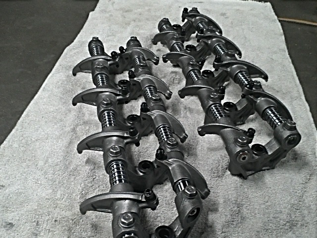

Just got em back from Rocker Arms Unlimited. Aint they purty!
Well,I sent them via usps. RAU did what they do. This is what I got back. Have another set with aluminum stands and extra arms that will make the trip sooner or later. These were a quick turn around of about 2 weeks.
What does RAU do?
Made 2 new rocker shafts,chromed em. Rechromed the other 2. Arms had new bushings installed. Oil holes redrilled. Pads were welded where necessary. All pads were reground and hardened. Stands and arms were shot peened. New adjusters and locknuts. Arms were fitted to shafts. New springs. New pipe plugs on new shafts and new press in plugs on old shafts. Reassembled,boxed and shipped.
Thanks! I'm bookmarking RAU for my future needs.
