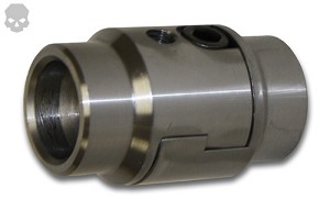

My car is a road course car rather than a drag race car. The stuff I do does not generally have any written requirements for a roll bar or cage as I am running with other "stock" cars. Nonetheless, stock seats are not much fun in the corners. I'd like to switch to a good racing seat(s) and a good set of racing belts, for my own safety as well as comfort. Can anyone recommend the best way to get a "Harness Bar" into the car without installing a full bar or cage? Or a way to do a four point roll bar with a harness bar (removable?) that would still allow me to put the kids in the back seat (when cruising)? I know it won't necessarily meet the drag rules, but it WILL be safer and more comfortable I expect.

These are legal, I believe, if you are wanting to make roll bar or cage installation easier and/or removable.

Have look at chris alston chassisworks .they do drop out taxi (belt)bars and also the same with intrusion bars
