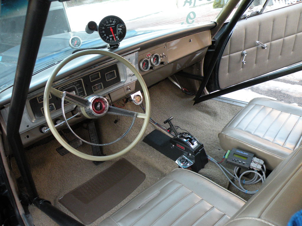

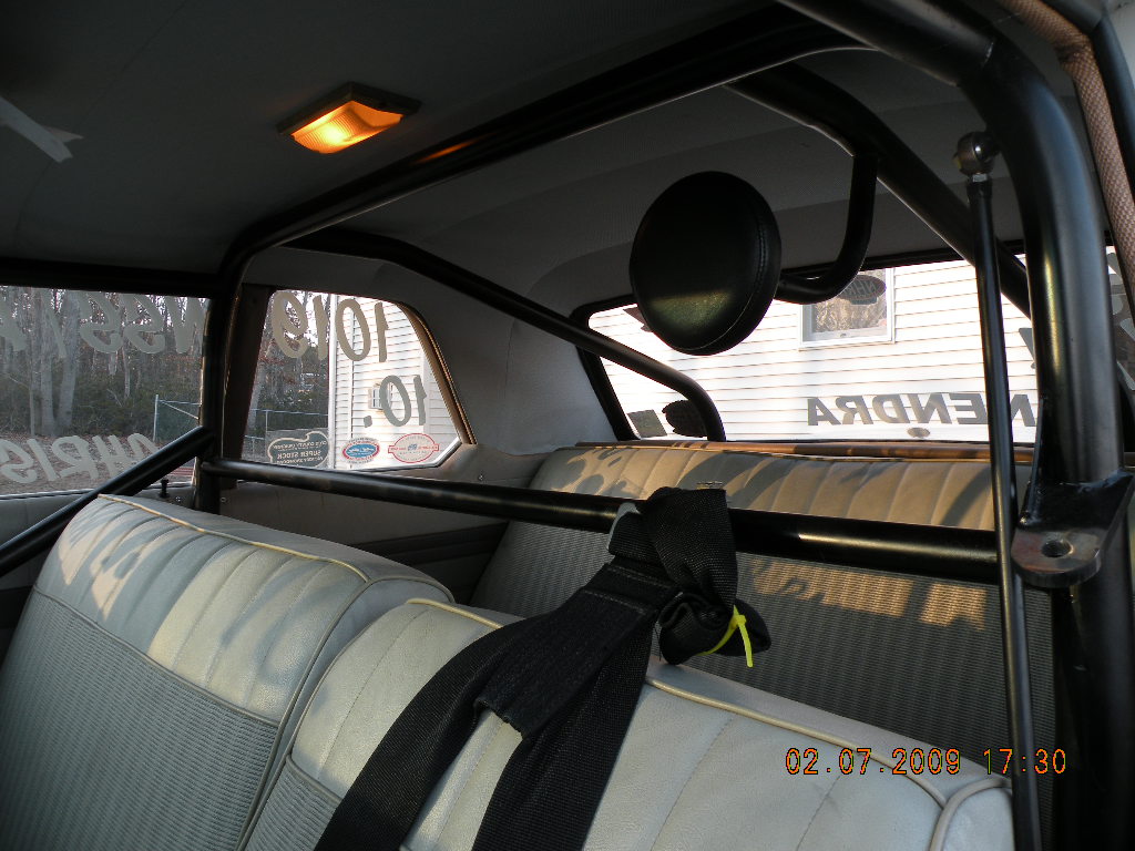

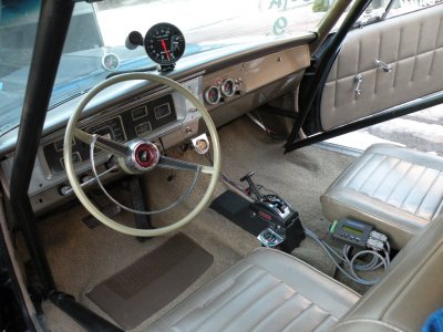

Cant compare the final result with a custom cage .

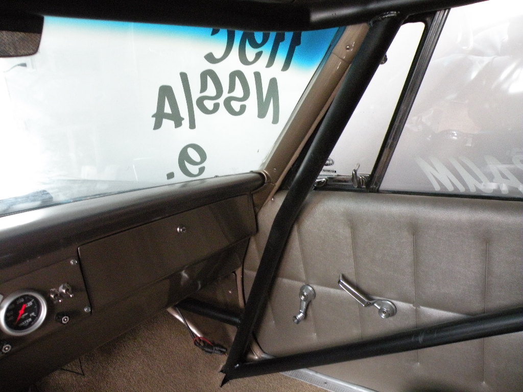

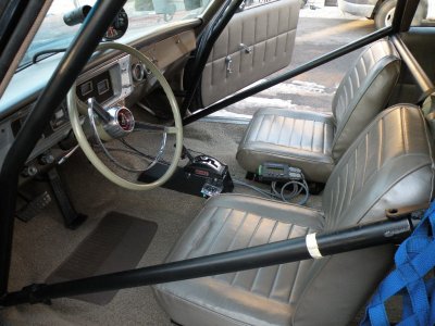

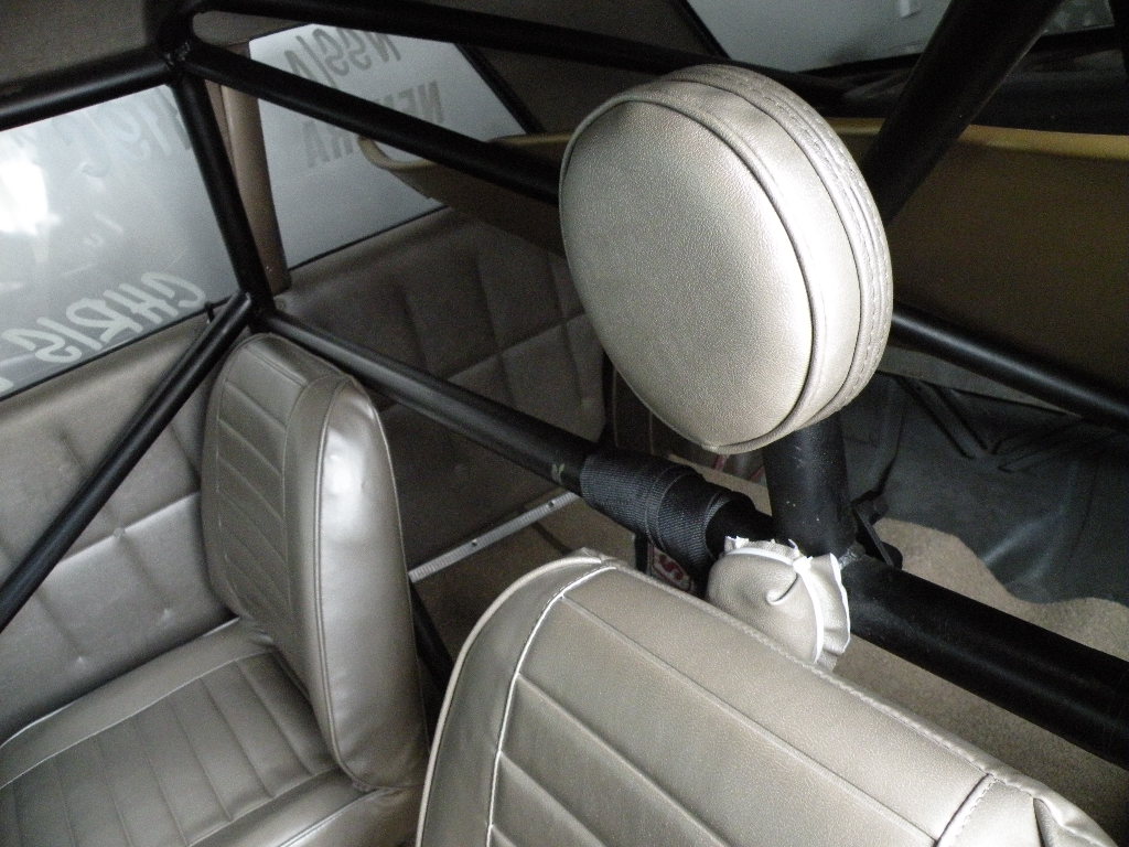

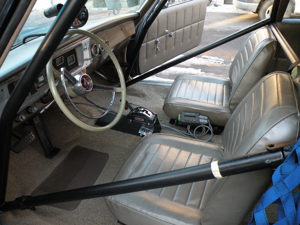

here are mine for example.

Wow guys thanks for the wealth of information! I know of couple shops guess ill see about getting some quotes...SSR thats pretty sweet! that would be perfect cause i wanna keep that back seat too.

The going price for moly cages run from $1500-$1800.00.

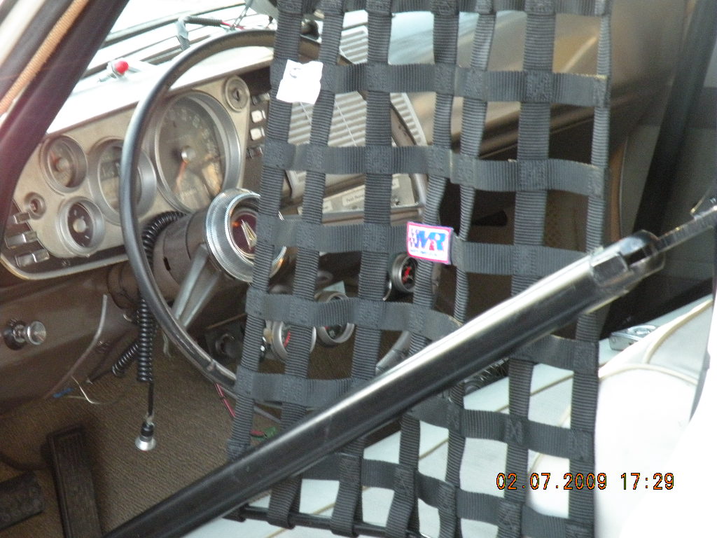

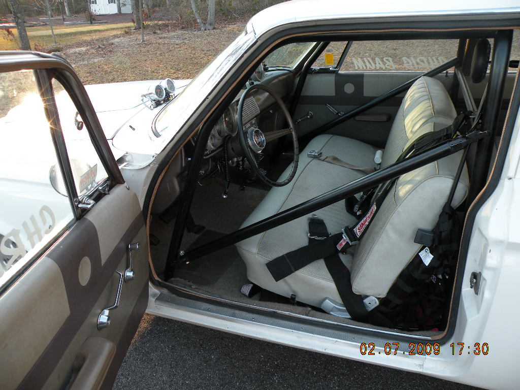

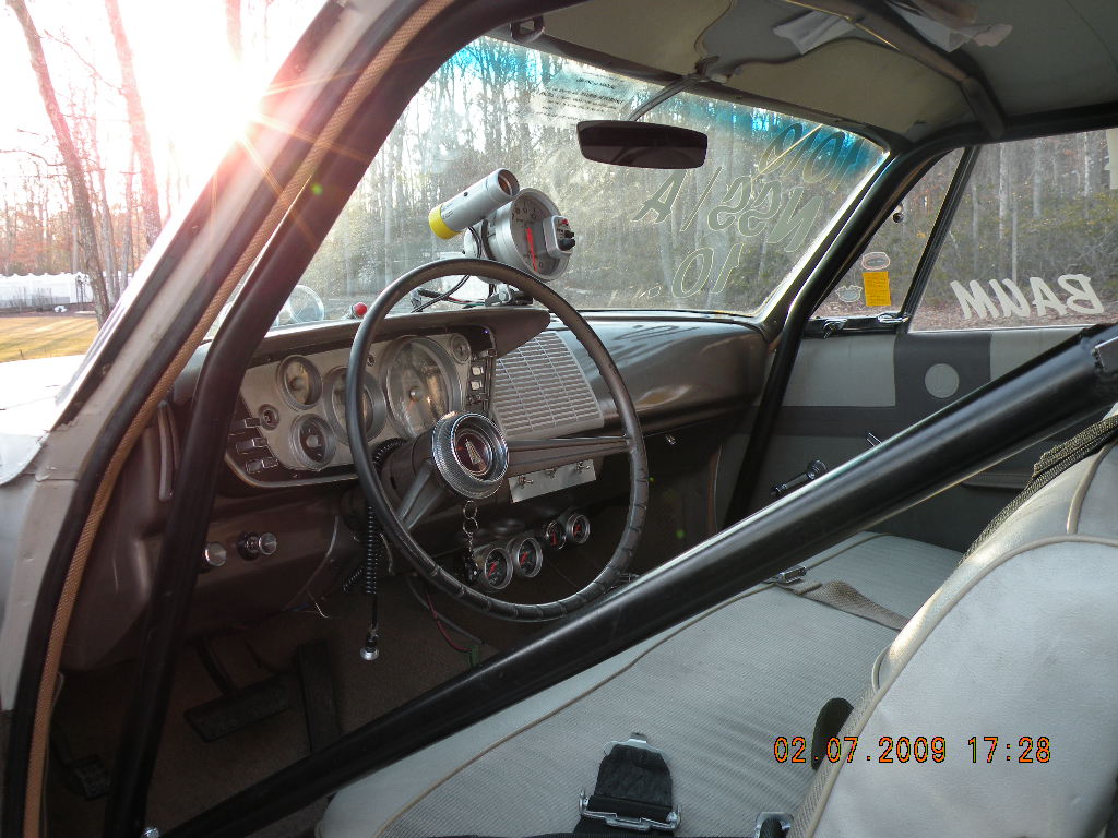

Its well worth a few dollars more. Lighter and stronger IMO. Get the swingout with the heim end like in my picture. Its $150.00 to do but much better than the cheap S & W swingout kit like in my 65 Plymouth
