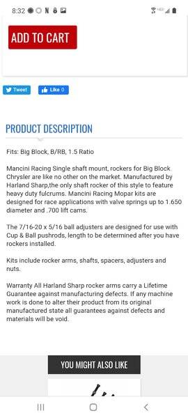

These are made by harland sharp but with bushings. We have these and original harland sharps with needle bearings. The bushings are a better fit on the street. Imo anything cheaper I would just keep w oem stamped steel.
https://www.manciniracing.com/mre5700192841.html
