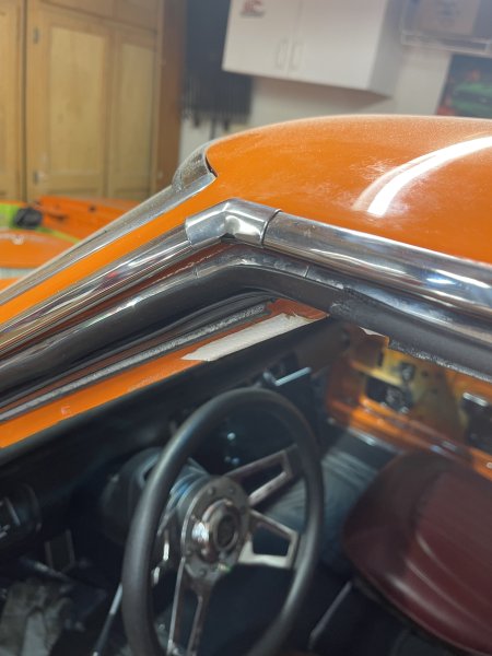

I installed my roof rail seal and it went ok. However I would like to see a picture of the front piece and how it’s glued in and trimmed, if trimmed. I noticed this is a large interference fit causing door alignment issues as it not trimmed of in place with glue yet.
This>>>
Have you got the moulded corner, at the top of the A pillar, nicely on place. That bottom end looks a bit low but not too bad.
About 3 inches gets glued and the squashed by the door.
Yes corner is tight and right. Great thank you Wayne! The picture is very helpful Ill trim off some excess and glue it in.
Don't trim anything !!!
You get most of it in and when you do the front you start at the bottom and work up to the corner. The foam will compress and fit perfect. As you've done it its actually stretched. You can tell where to start because the shape of it changes where it fits into the trim.
You start putting it in the trim where the arrow is pointing. From bottom to top.
