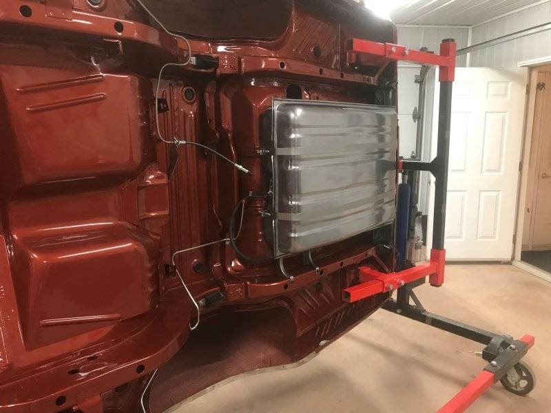

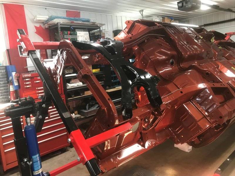

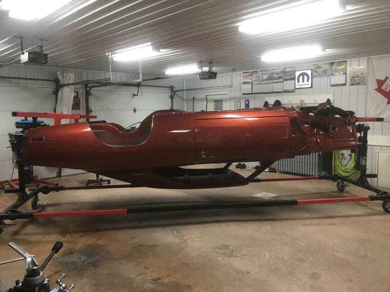

Here are two pics of my car set up. You can see the front and rear screw jacks and the difference between them. You can not go by what mine looks like, as your attachment points can be different and that makes all the difference in the world. The way you see mine it was a one man easy spin 360 degrees. Took some playing around with to get it that way. As said that anything you add or subtract will change how it rotates.

And yes as you add parts you will have to readjust. I now have the front end, fuel tank, fuel/brake lines emergency cables installed. I'm calling it quits at that. I still rotate it all the way around but makes me nervous.

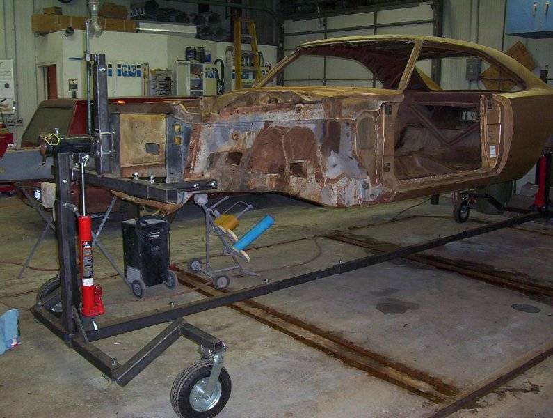

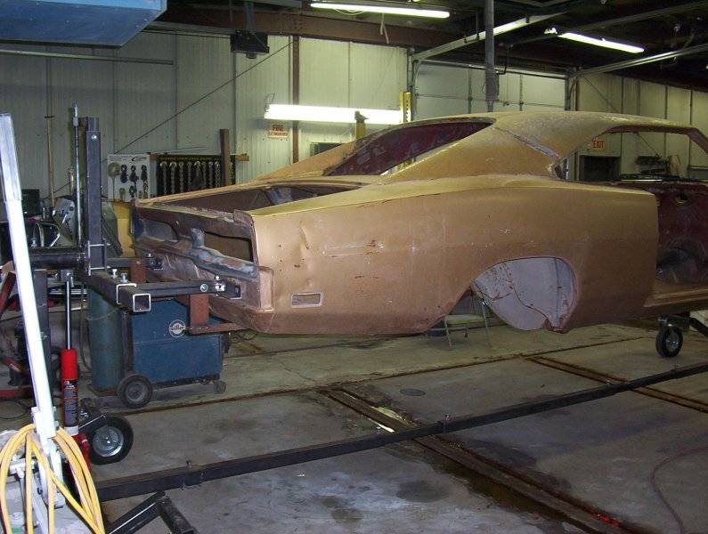

When mine was "perfectly balanced" she could sit anywhere on the 360* That's when she was empty. Mine has the locking wheel (sprocket cog) you can see it in the top photo. I only had the one. But there was jamb bolts on both ends to help steady her. I never used them only when I took her home. Nice to have. Actually a must. When she's at the edge of balance it would take nothing to move it. While sanding, trying on parts for fitment and the like. There was enough drag that she sit where you put her. Yet I could spin it like the wheel of fortune.

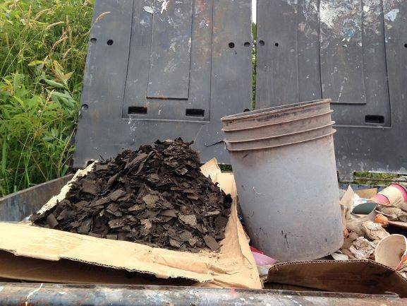

Yes! They are great for that. Just stood there with propane torch a selection of scrapers and a wire brush and scotch pads. Did the whole underside of my 70 Charger in about 12 hours. With the odd beer break. :drinks: I collected a rounded 5 gallon bucket full of undercoating!

Yes the more the merrier. I found that table spoon did beautifully in the curve of the rear wheel wells. Just warm the metal till the undercoating starts to soften up. It will scrape right off. So much debate over whether your putting to much heat to the metal??? Just need to warm the metal. No glowing or no where's close to that. Then I would wipe it down with a readily available inexpensive degreaser that I had kicking around once it cooled down.:lol:

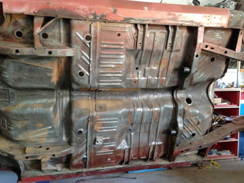

Got the under coating off couple years ago , using heat gun , putty knifes and wire brushes ,it was on a car lift than, while it was on lift welded frame connecters on , When i put car on rotisserie and put it on it side the welds on frame connecters look bad , starting to grind welds smooth , hard for me to weld from the bottom can do a lot better job now where I can get to it , much , much easier on a rotisserie.
