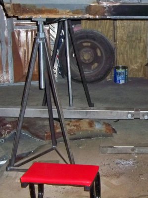

My tall jack stands:headbang:

As far as bracing, I sure would. I have a '68 ragtop on stands right now and a '69 Hardtop. I can tell you the vert is like a slinky up on stands compared to the hardtop. Can barely get the doors closed or the trunk lid. That should give you an idea how much these cars flex. Being a uni-body and you're removing large sections of the structural support, time to brace.
