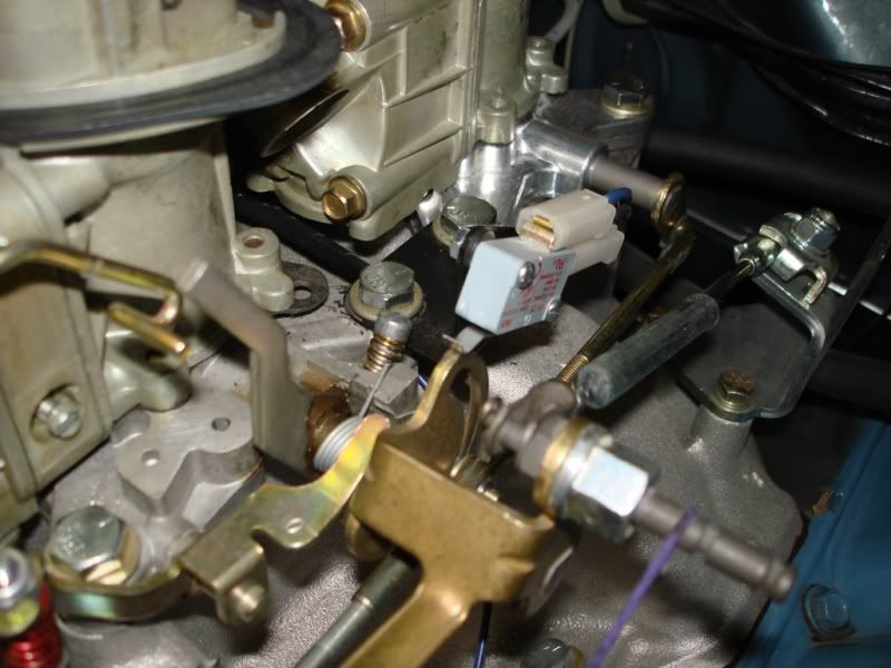

I built an A/C clutch cut-out based around a generic RPM switch intended to be used for a shift light. Controls a relay to open the clutch circuit. Also, running a modified micro switch on the center carb acting as a throttle position switch, additionally opens the clutch circuit with heavy throttle input and low RPMs.

I also will instal a micro switch like 72RoadrunnerGTX did, in that way Compressor clutch will come off at what comes first, throttle ( passing a car on highways for example ) or RPMs
