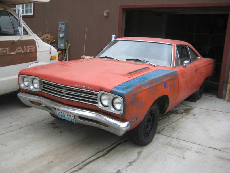

Here is what i started with. A 69 post car, bought on ebay from Oregon. According to previous owner it had beent sitting in a garage for 15 years or so. There are some rust issues to deal with, but not to bad. 383, automatic.

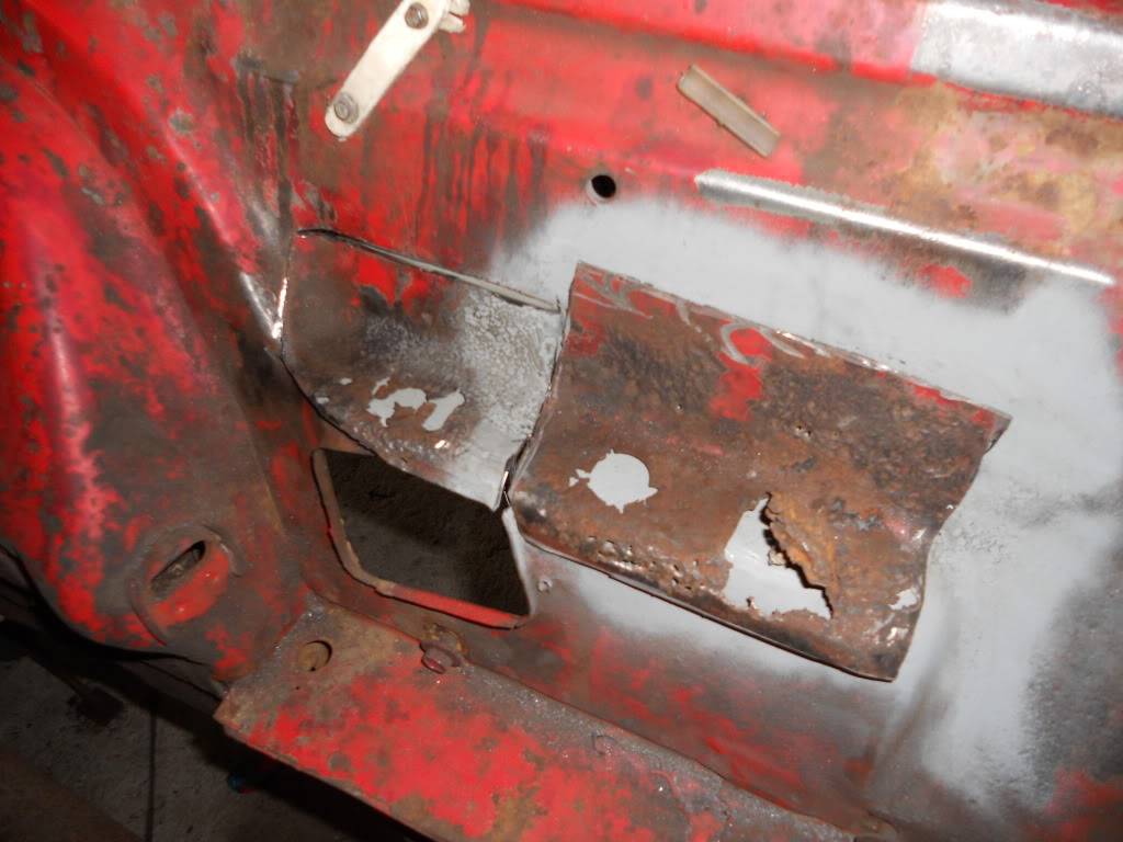

- engine bay (battery mount)

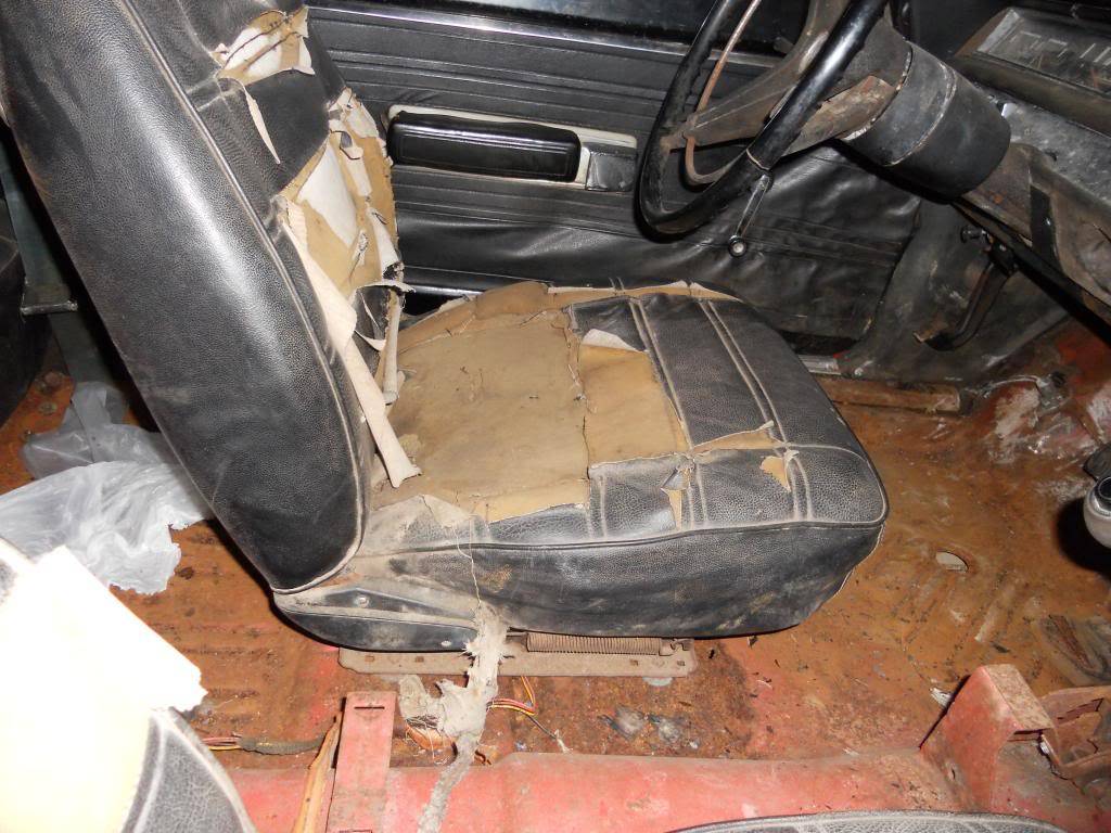

Crap interior

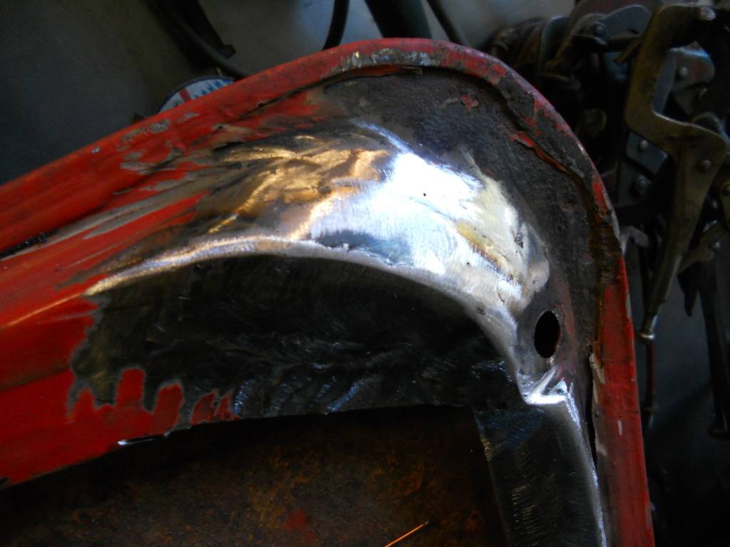

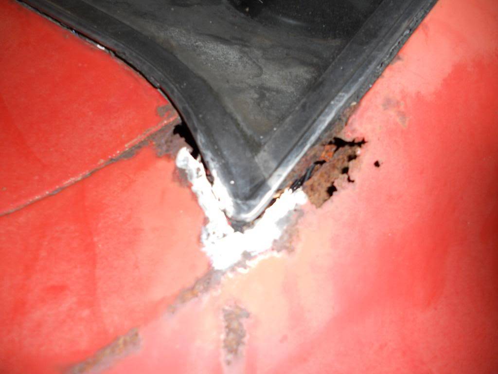

Rear window corner

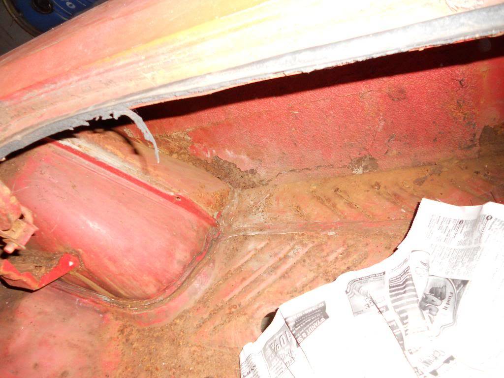

Looks bad, but mostly surface rust. (exept floor)

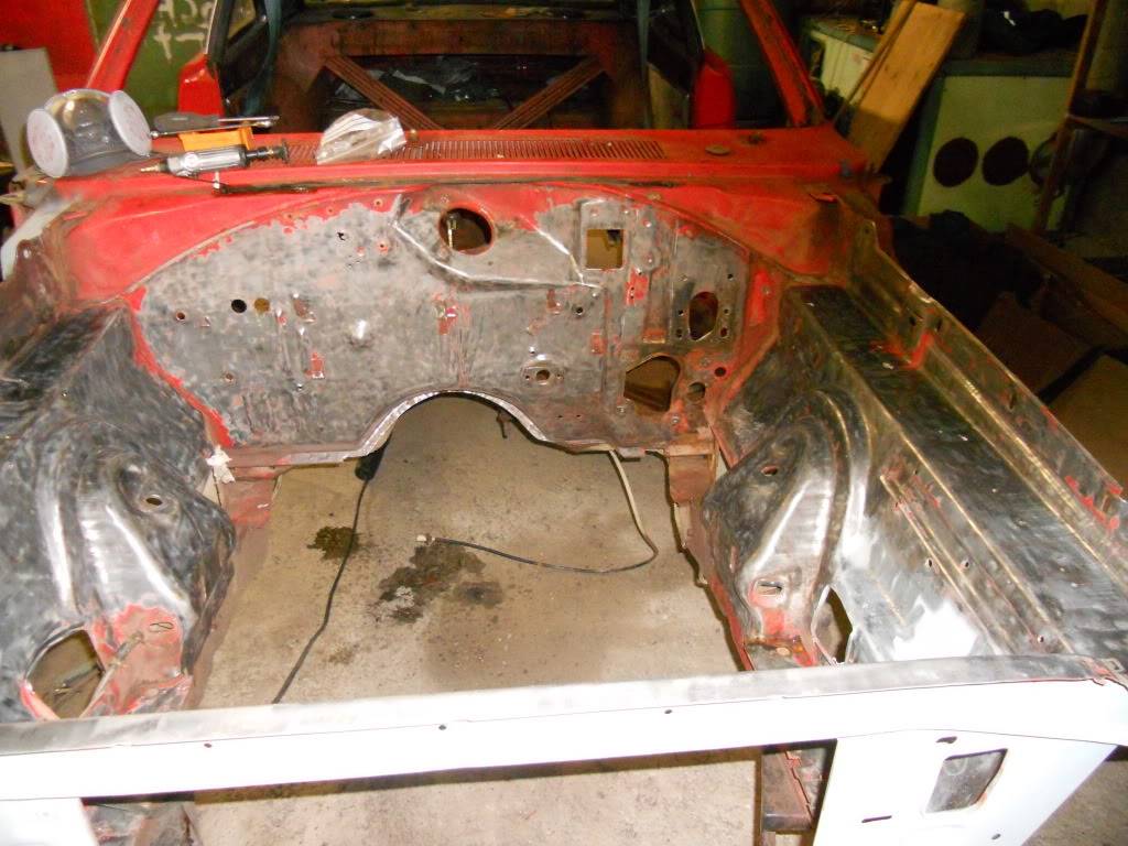

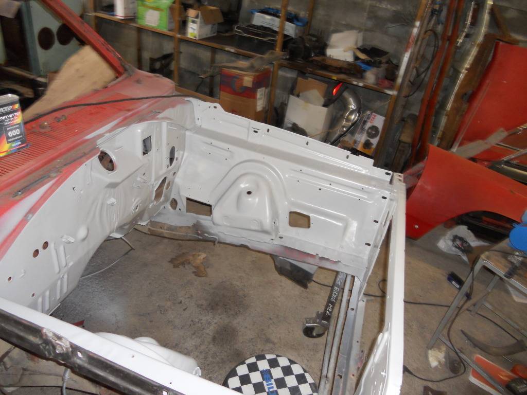

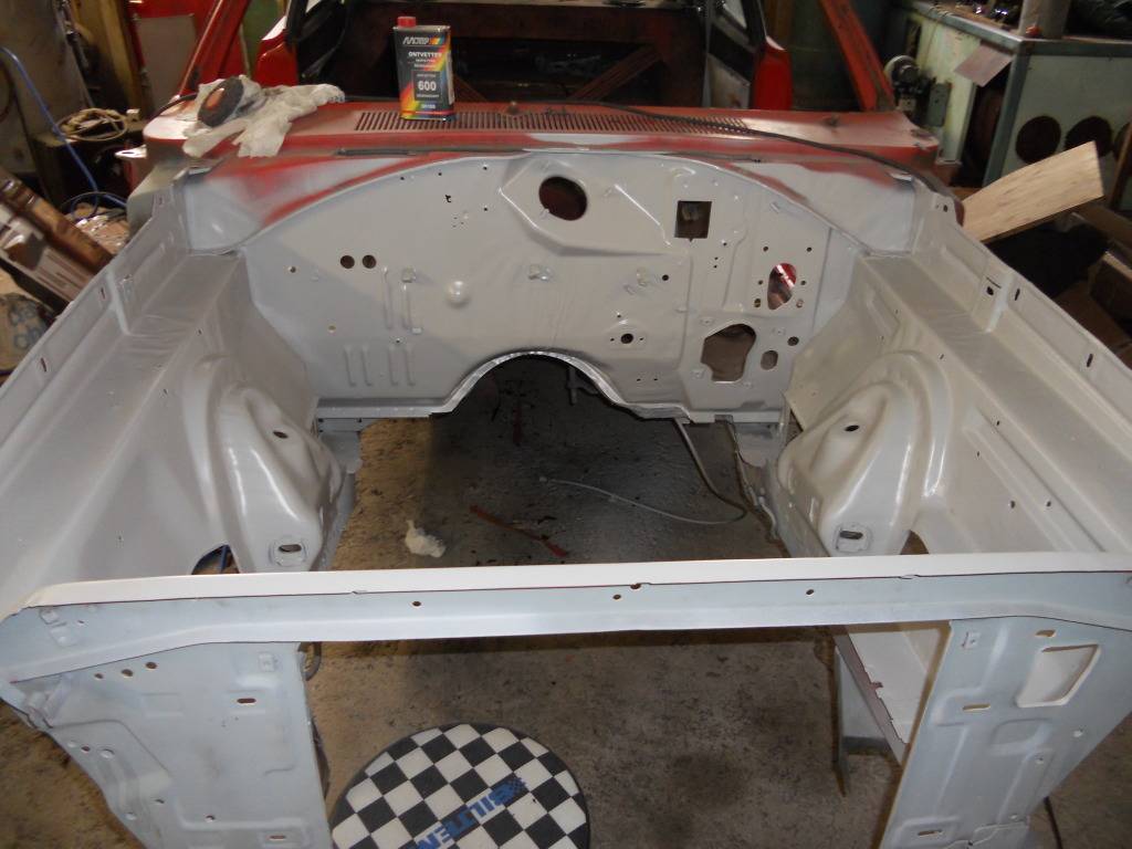

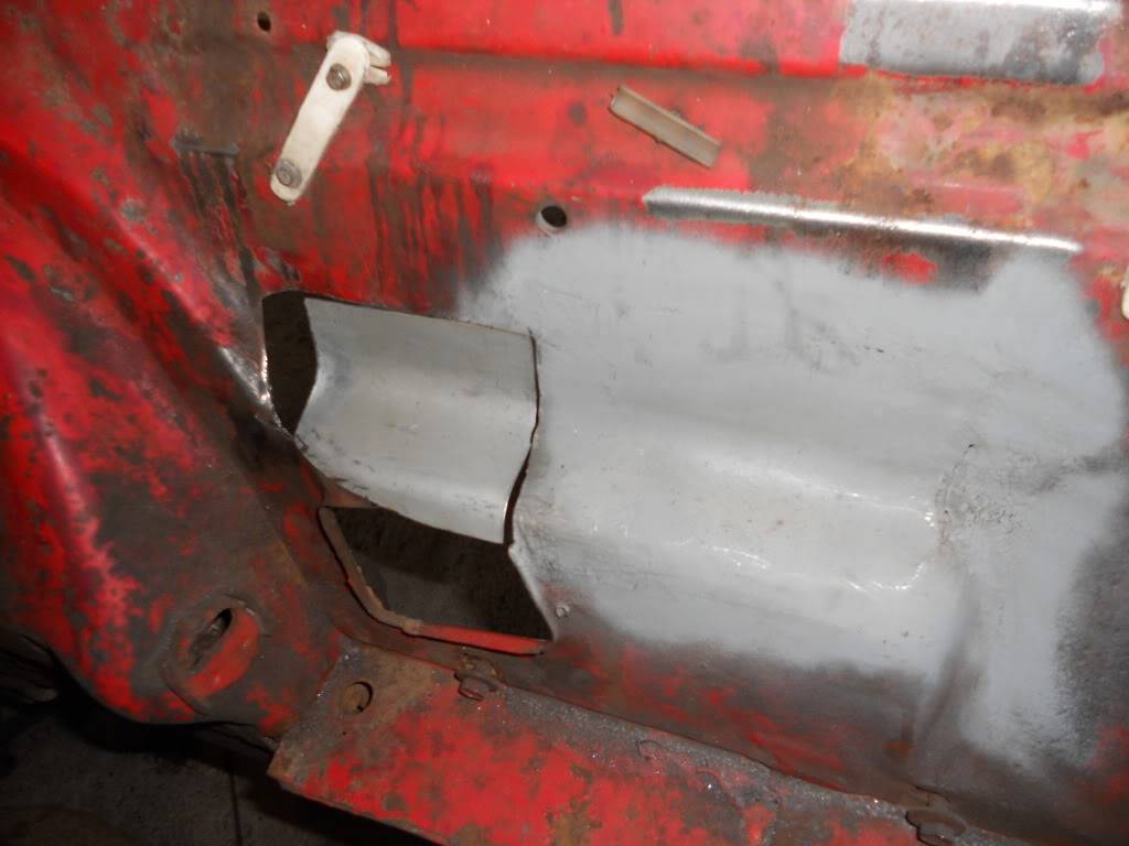

Engine bay soon ready for primer.

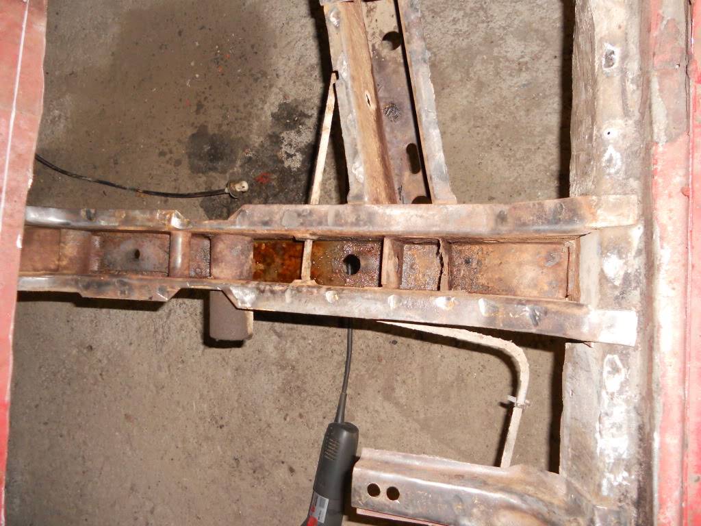

Frame under floor, fairly good

Going to clean up the engine compartment some more, but laid an epoxy primer on it for now. Not to happy with the result, had an old siphon gun of cheapest sort that i think did not do the job well (although it is most likely my skills that are missing:head_smack:), spitting paint all over the place:eusa_wall:. So i bought some new ones:happy3:

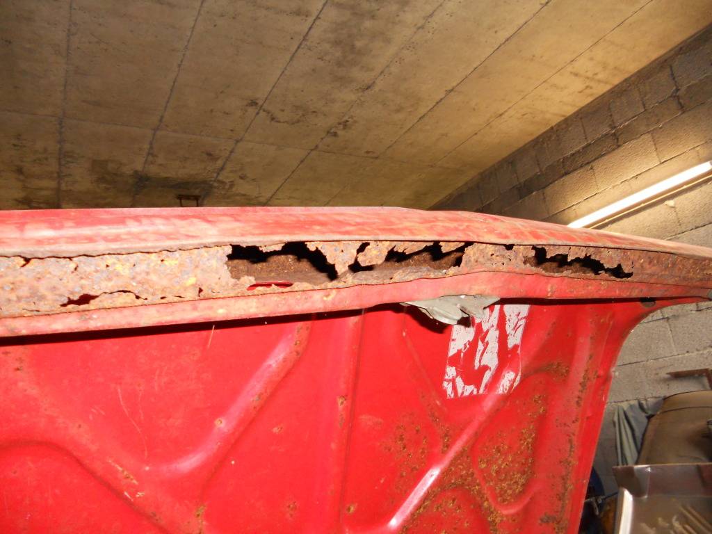

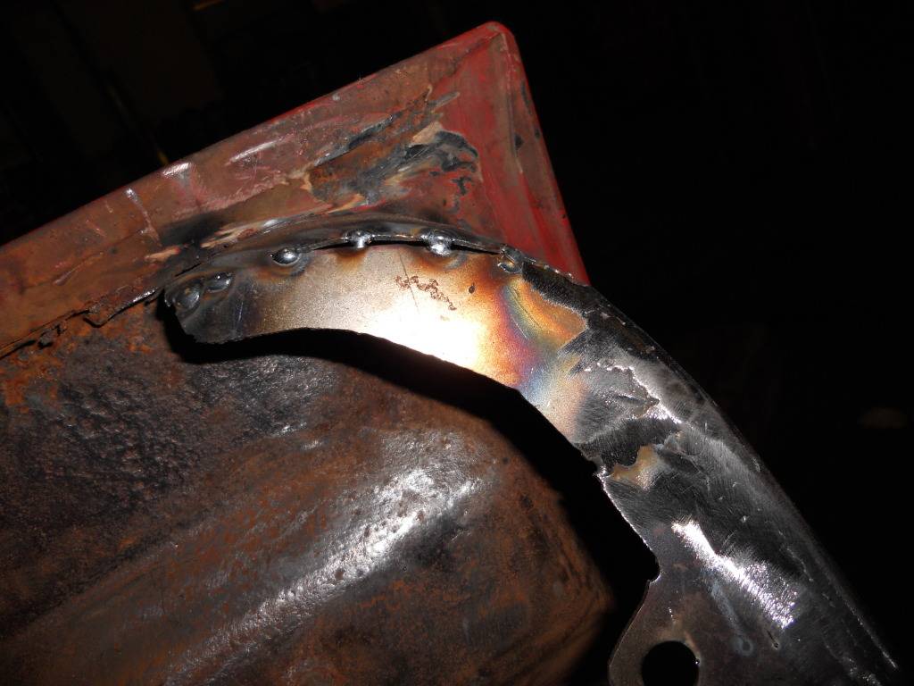

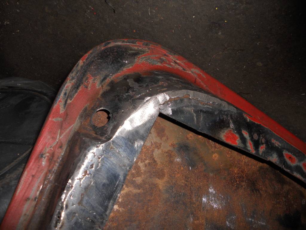

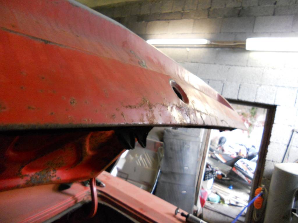

I have started working on the trunk lid, wich was in a bad shape. Gonna try rescue it, make it as good as i can. I think it will turn out good enough to start off with, then maybe get a new one later when fundings are better. really expensive to ship larger items across.
Pretty rusted

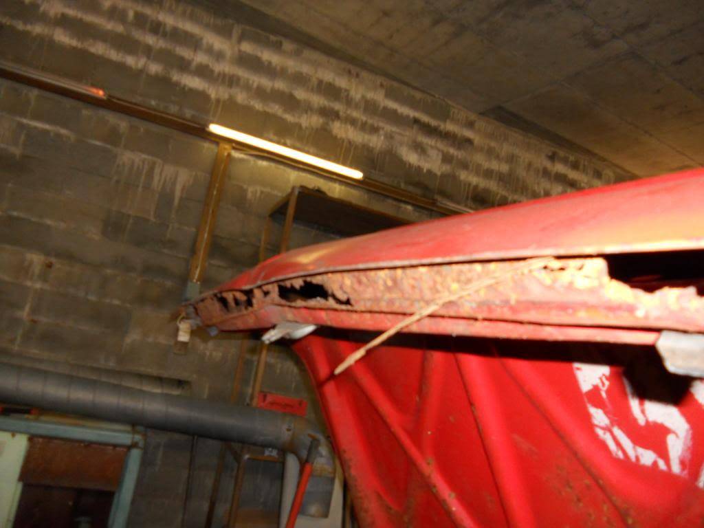

Somebody f***ed it up once, probably didn't have the key

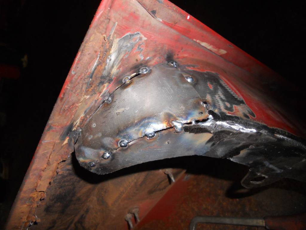

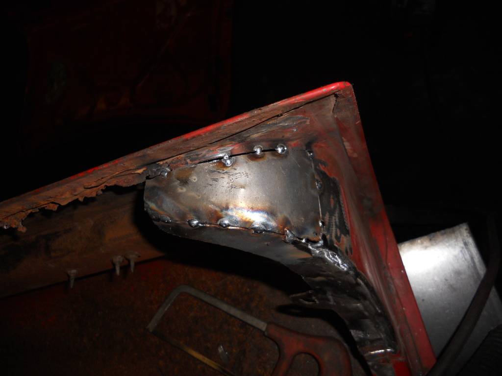

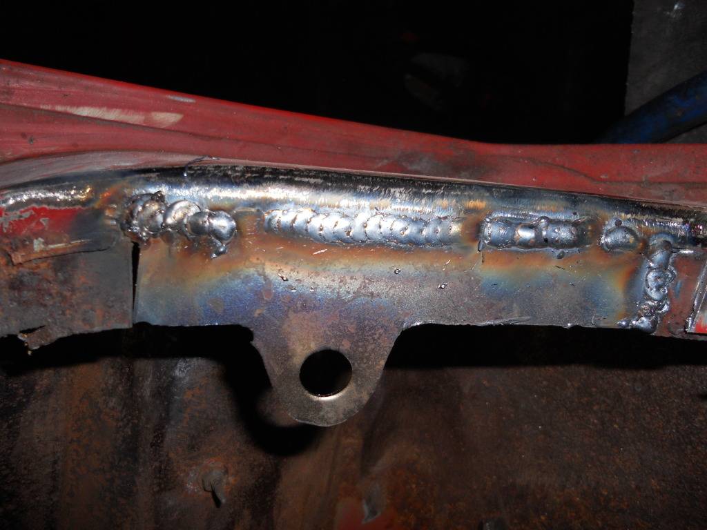

Decided to cut out the inner structure rather than separating it from the skin, think i made a mistake doing that.

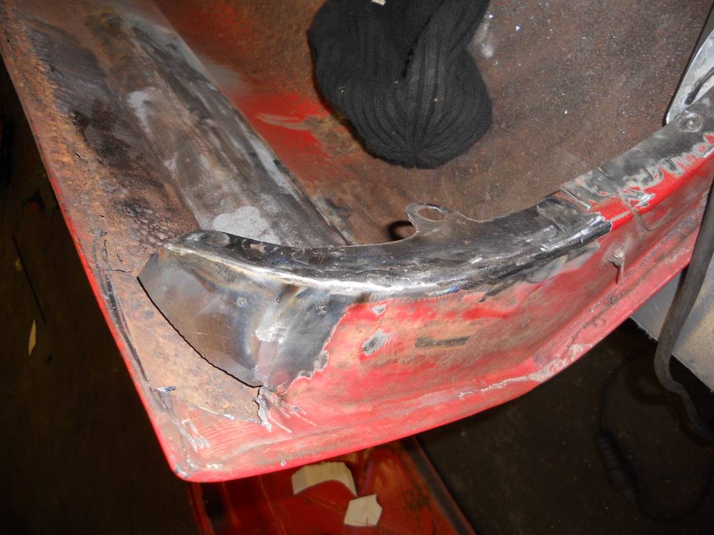

Got some of the patchwork done
