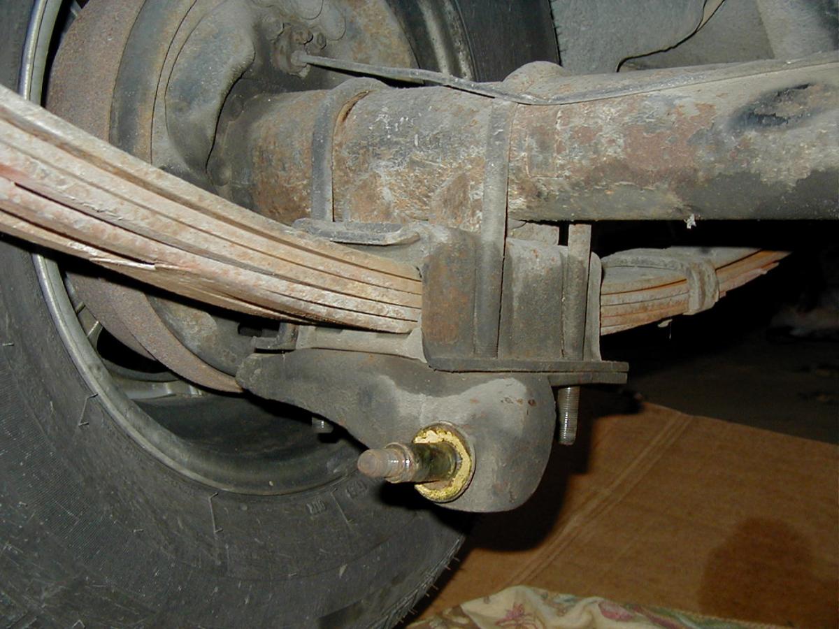

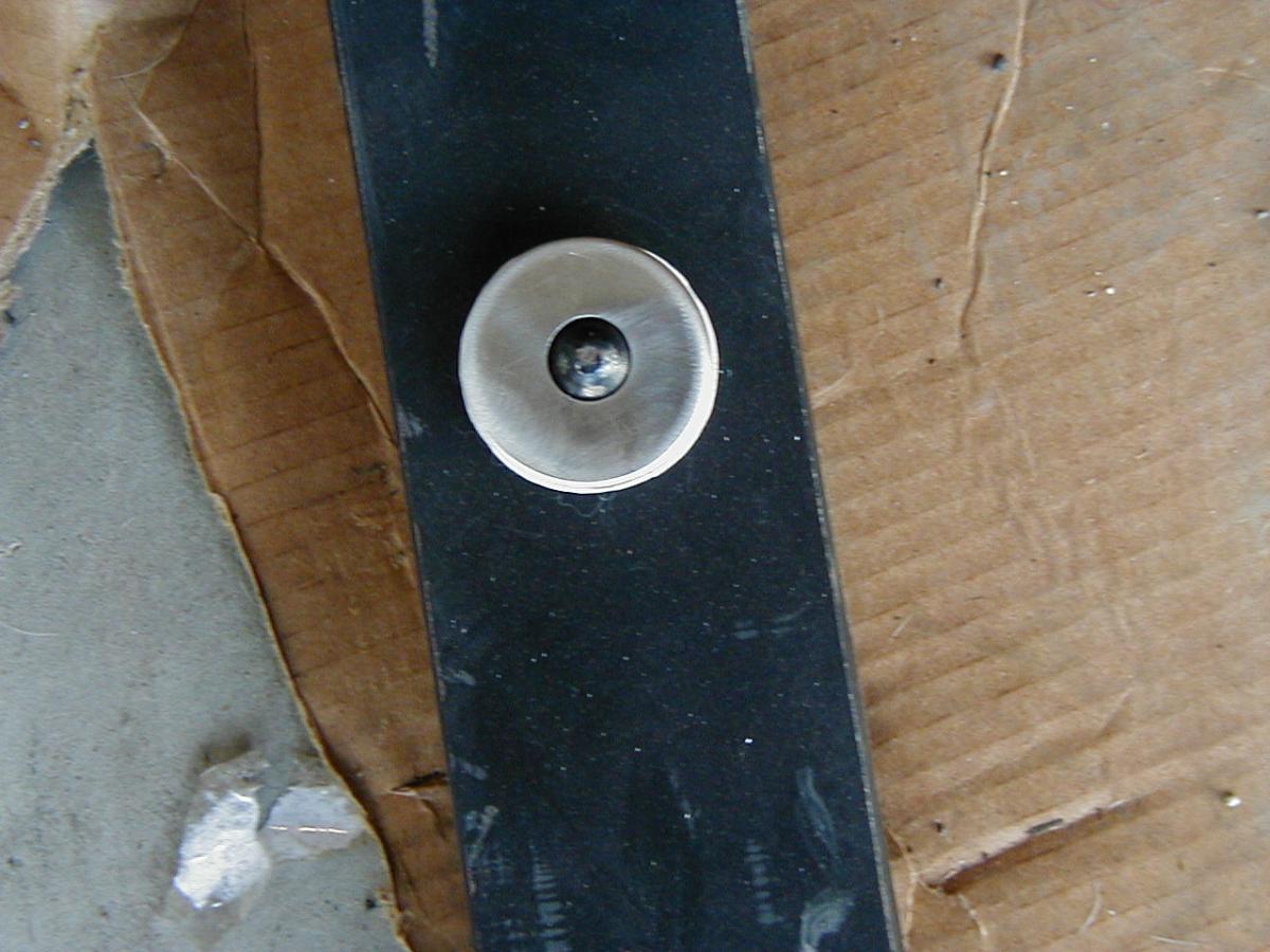

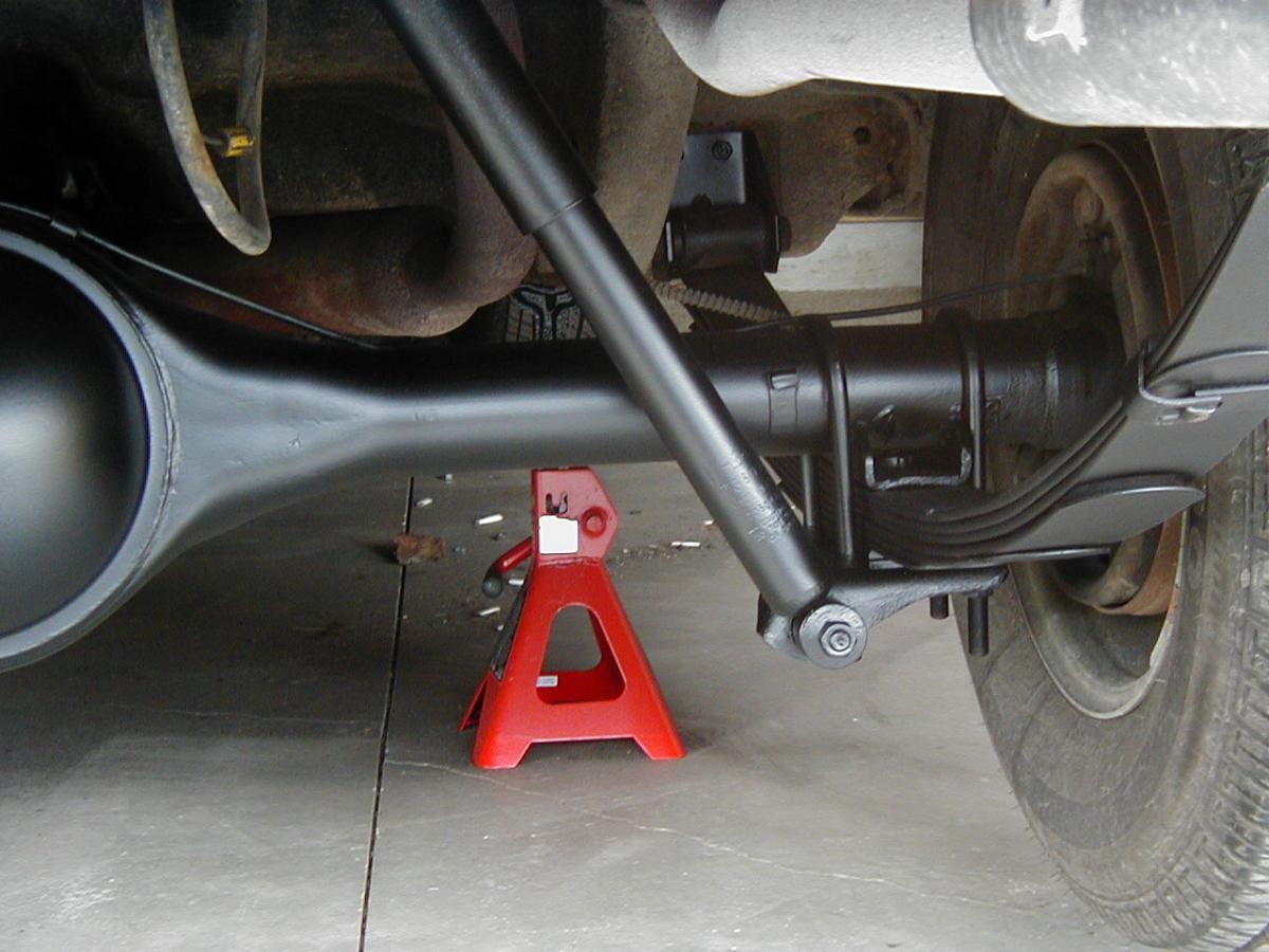

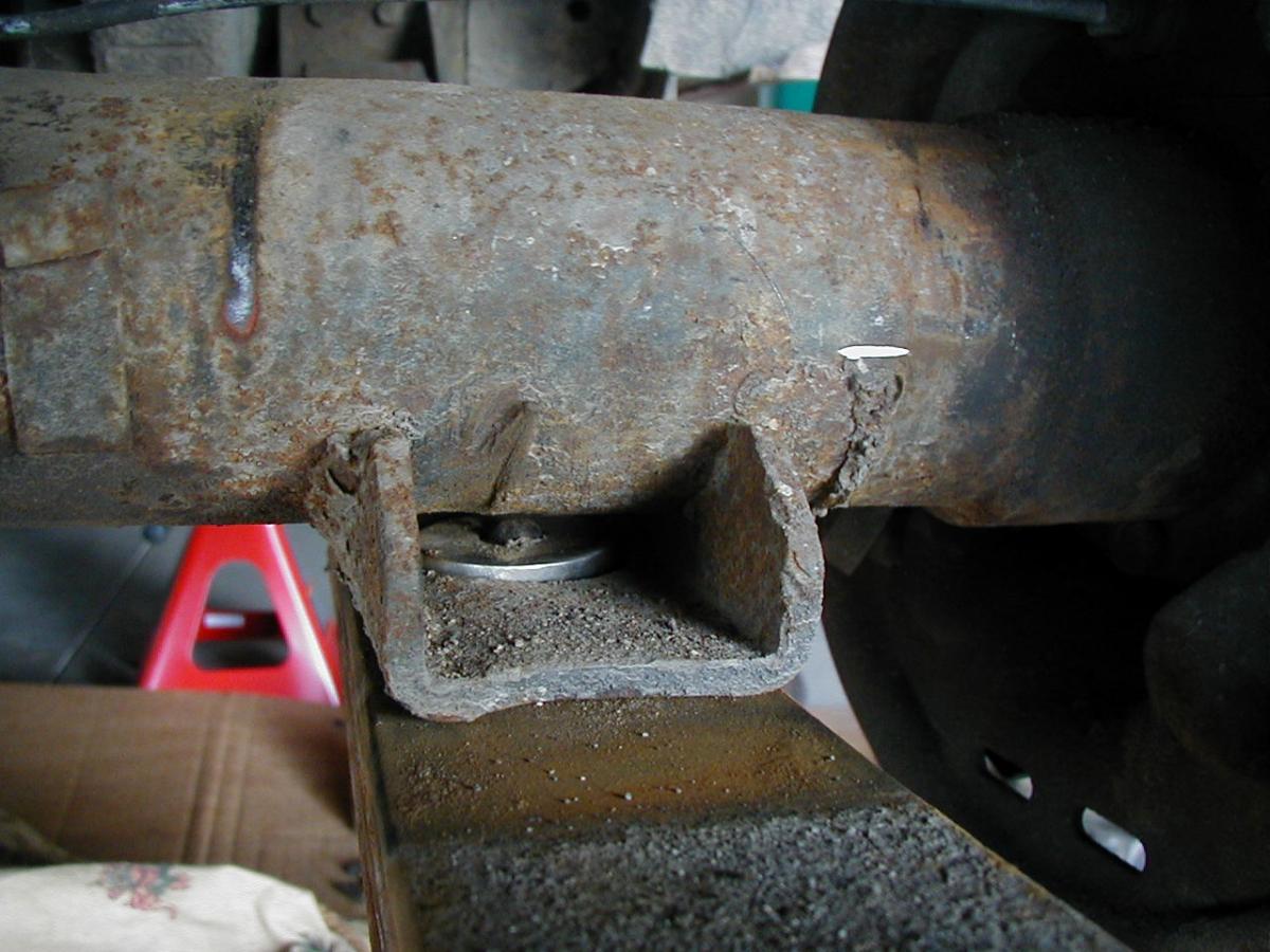

Sounds like you have the same rear end that I do. I did away with the rubber all together and eliminated the problem with the shock geometry. First get a set of shock mounting plates for an early rear end. Secondly, make a steel bushing that will fit the opening in the spring perch (assuming you have a perch with the large hole) and drill a 1/2" hole in the center of the steel bushing. Place the bushing on the 1/2" pin on the springs. Now mount the early shock plates and as you tighten the plates up the bushing will be raised into the large hole in the spring perch thus centering the spring. No more rubber to worry about.
