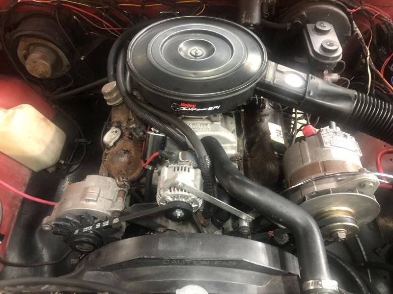

I’m running 3!

The "stock" alternator is connected to a heavy duty, adjustable stock style regulator, and still has the feed to the bulkhead the other 2 have internal regs.
I run 2 batts. and the voltage never goes above 14.2, all 3 are connected straight to the batts. which are connected together.
The best part is when I raise the snow plow, only drops to 13.5 volts!

But I know why I am running two, but three is above my pay grade, what is the secret sauce here for three? Are they all on same battery?

The 3rd one was only added a couple years ago to replace the non functioning a/c and keep the same belt routing.
