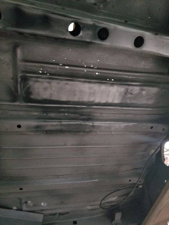

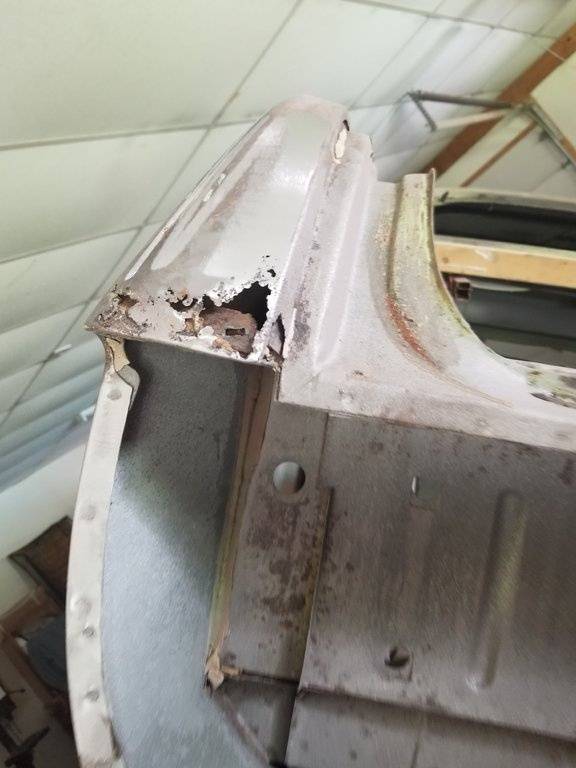

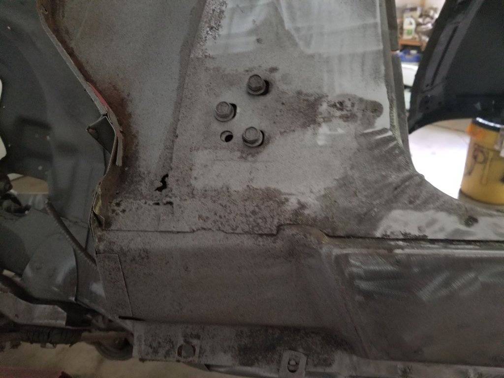

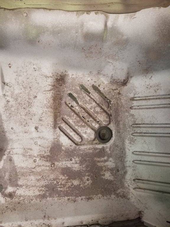

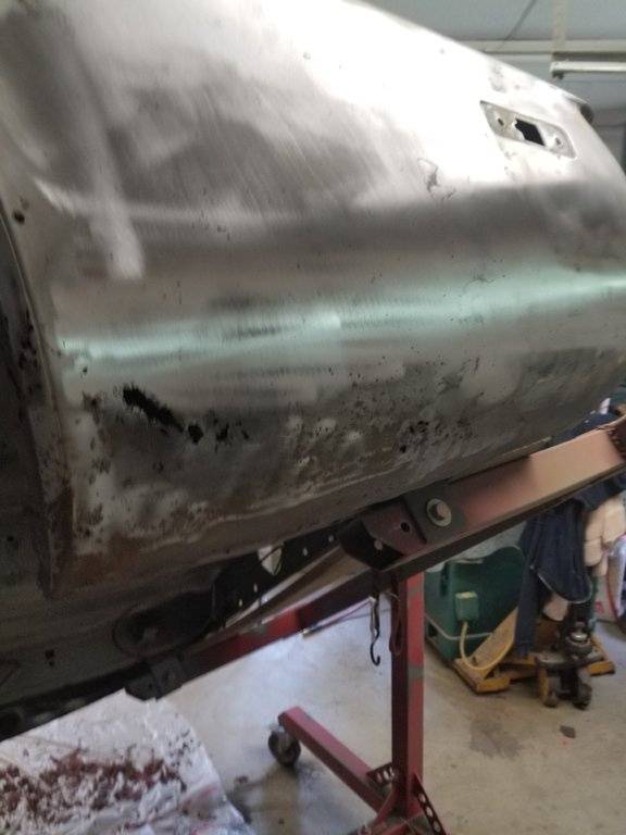

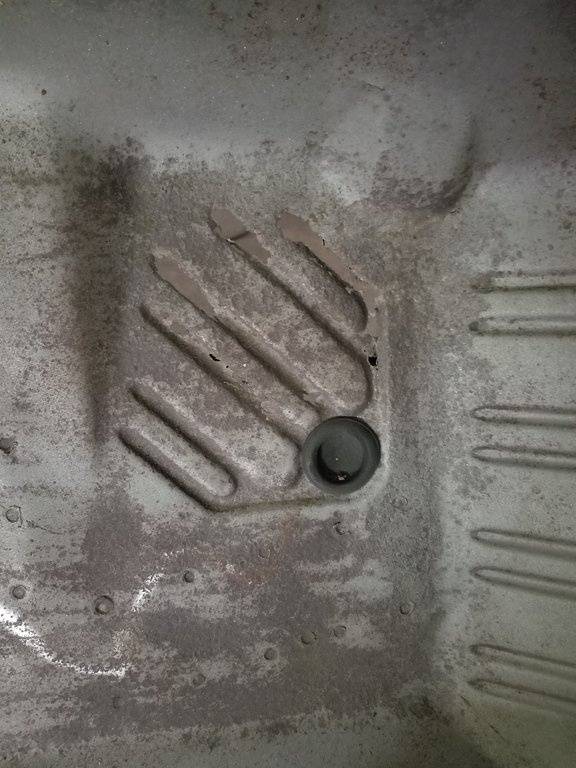

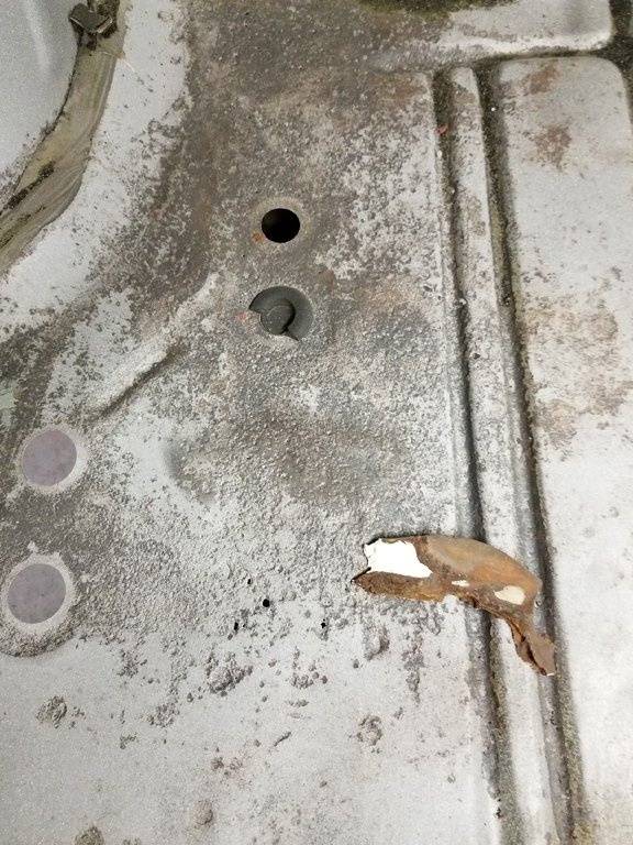

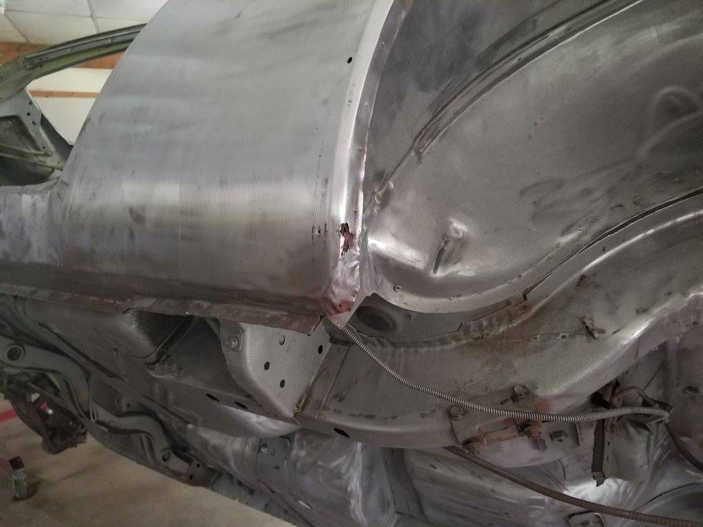

Hello everyone ! I've got some rust holes in my 73 roadrunner . I know I have to replace front floor pans . The left quarter has rust low. Its not a show car, just a project my son and I are doing. Hard to get parts for the 73, but I can get a quarter patch for left quarter. Here are some pictures of the problem areas, any advice is greatly appreciated !
Your going to have to cut them out and weld new pieces in, or make patches on the back side and glue them in with an overlap using body shop two-part epoxy adhesive. Then you can bondo the outer side. Leading is good option as well if you know how to, using a backer piece. Sure got a lot of bad, tricky spots to do.
Screw bondoe....dress with epoxy with chopped fiberglass in it for any fill work.
I do have some tricky spots. And I'm a novice at best. But I can weld some. So do you think I should just repair the trunk pan? Also fiberglass the spots on the top rear of quarters ? Metal seems kind of thin there. What kind of epoxy should of get?

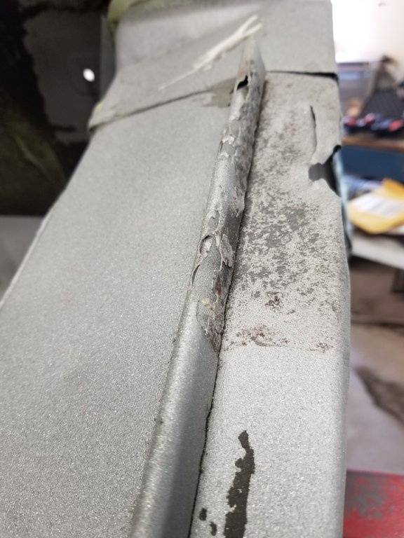

Here is the back tips of the quarterView attachment 500636
That large of void You should trim away all the diseased metal back to good metal, square the hole up, acid etch everything & weld in patches. Keep in mind that welding heat is going to cause distortion in surrounding unstressed sheet metal, creating extra surfacing bodywork. You can trim & clean the area well, etch with acid(inside too)& stuff it up w/ epoxy filler thereby avoiding extra bodywork due to heat distortion & the car will probably rot around the repair before it gives up. Also save considerable time opposed to patching with steel, but hardcores think it an improper way of doing things.

Some of those floor pans of Yours that are only lightly perforated, You could grind, etch both sides, & spread epoxy filler(one side at a time). Back one side with masking tape, spread on the filler, let it kick, then go to other side, pull the tape, wipe down with acetone & spread that side with the epoxy. You'd save Yourself a ton of time.
No matter how stiff You make the mix, You can spread it as thin as You want. You have to develop a feel for the spread, it's not like spreading bondoe.
*important note* with ANY filler, first spread thin with Force the entire area, so it's well pushed onto surface, then You can lighten Your pressure while spreading to achieve a build up of material.

its already stripped on a cradle? cut and weld.. your already set up..
