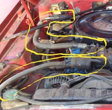

I'm curious what years used these 2 hoses/lines? I assume no repros are available? Any info is appreciated.
Thanks.

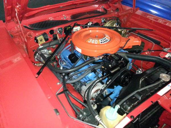

I believe 73 and some 74's used those hoses.
When I did my upgrade to 134a during my restoration, I had Classic Auto Air in Tampa rebuild them, it was about 130 bucks each, but they were also upgrade for use with 134a. Here is what it looks like.

Yes, basically that is what they did was replace the rubber and put new crimps on the ends of the original connectors.
If you convert to 134a, you can use the original evaporator and condenser. Any rubber hoses need to be replaced with 134a compliant rubber as the molecule size is different for R12 and 134a, and will bleed off if you stay with the R12 stuff. The compressor should be rebuilt and have the oil changes to be compliant with 134a also. There is one metal hardline with a short section of fabric on it that needs to be replaced with rubber for 134a. Also the drier should be rebuilt or replaced, new ones are available.
