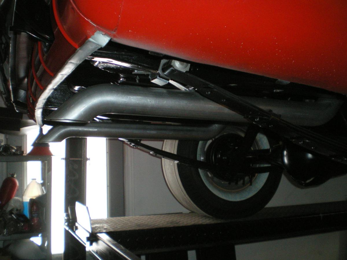

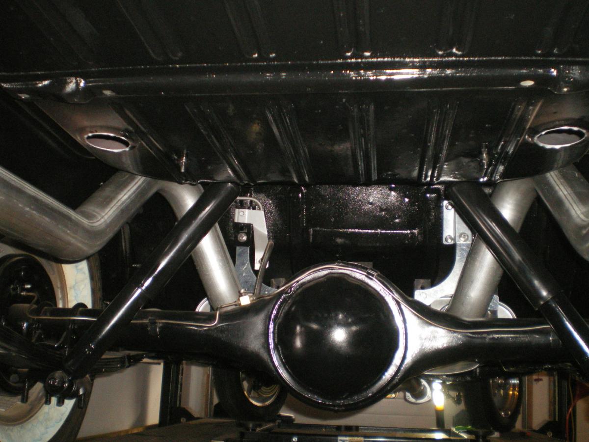

You dont need those front hangers, the stock one will do. I put SS spring on my 62 Savoy which is the same as the 63's . You will need to get longer shocks though. I used stock 1500 dodge Ram ones from 2003 and they fit perfect but you have to press out the rubber from your old shocks in the bottom mount and press in to your new shocks. the lower mount on the bottom is larger than the stock Ram ones.
