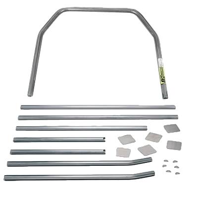

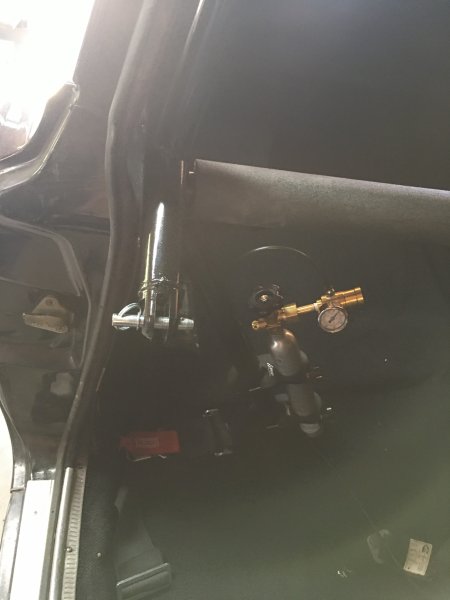

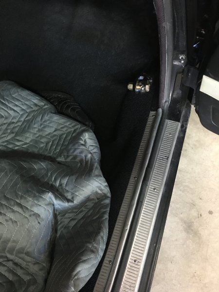

here ya go, notice how close fit the vert bar is to the post. definitely Not a universal fit unit.. 8 point unit that is plate bolted to the floor on the main loop and all others welded to the frame rails that construct the backhalf except the front lower door bars. they r plate welded also, the door bars swing down.
Ok, thank you. Those shots will give me some stewing material on what/how to prep the area.
