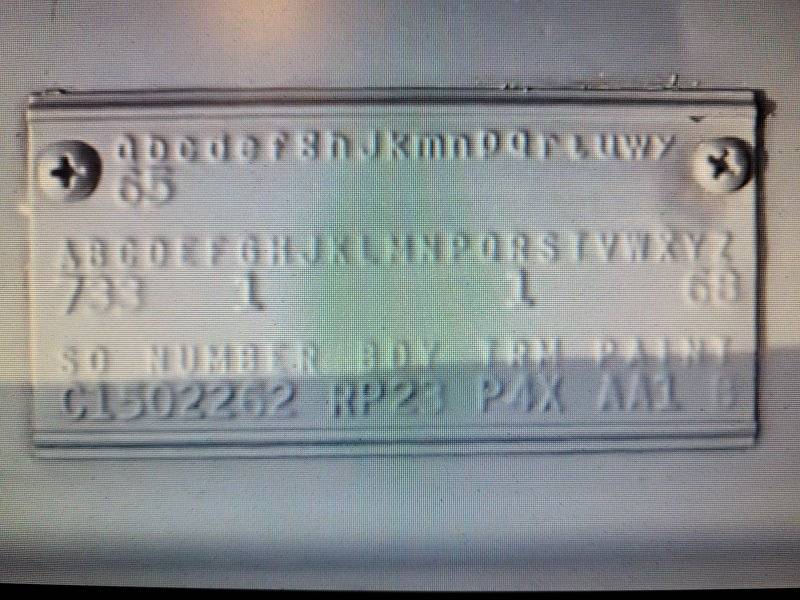

Hi Tommy France, A picture of the tag would help decode it.
However the A before the order number would designate the plant it was built at. In this case it would be Lynch Rd assembly.

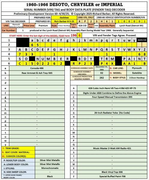

'68 tag... "A" would be an October 67 SPD build date. Here is my '66 with a C15, that is December 15th, 1965
