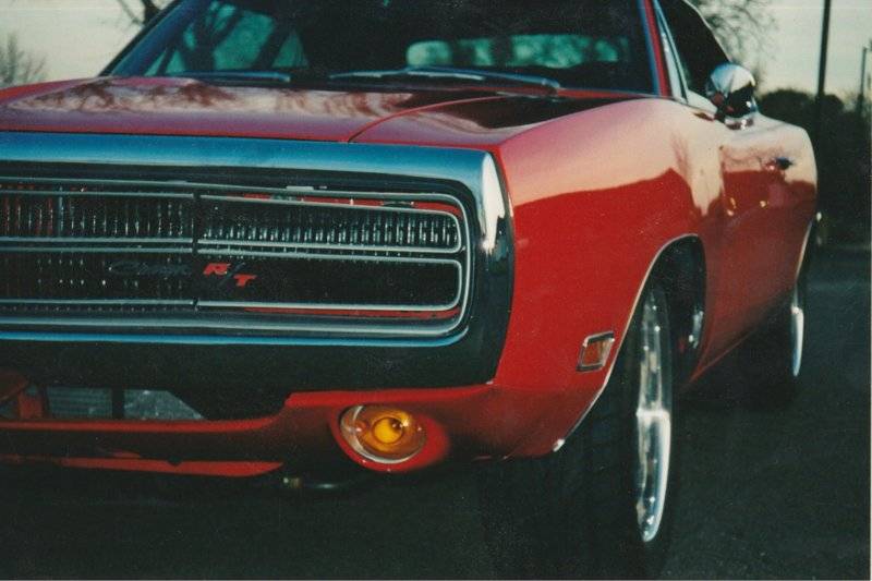

I run a 295-45 out back, a 275-40 up front. I like the big and little look. Nitto NT-05 tires.

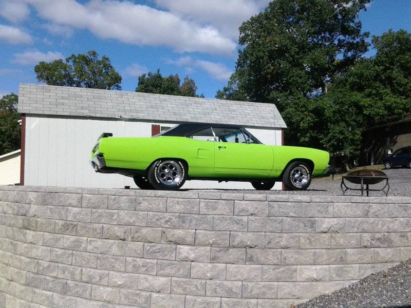

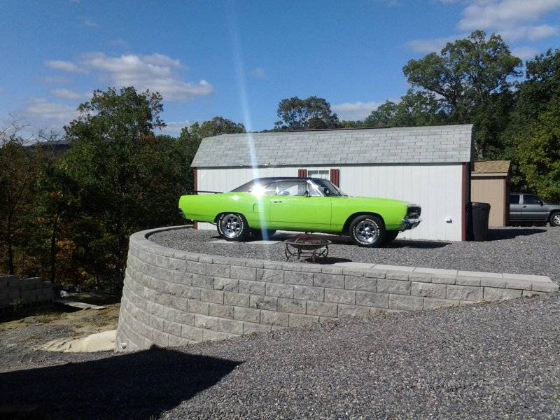

Nitto 555 275/50ZR17 for the rear, 245/45ZR17 front; both of which can fit on a 8"w wheel without to much headache. Hotchkis leaf springs with 2" drop Spindels.

That front tire is 26.7”. Any issues with rubbing? Are you maxed out in height?
My wheels are 18" diameter, sorry I forgot to mention.
Also, I don't always trust published heights but you may be right. The only rubbing I get is with the inside edge of the sidewall against the frame rail, a smooth surface. No rubbing to the fender at all.
I am actually lowered a little bit. I am more into handling and the roads are pretty decent here so I don't need to have the car higher than stock.

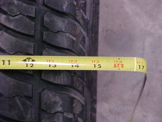

17x9.5 with 5.5" backspacing on the rear with 275-60-17 tires (about 30" tall)
15x6 with 3" backspacing on the front with 225-70-15 tires

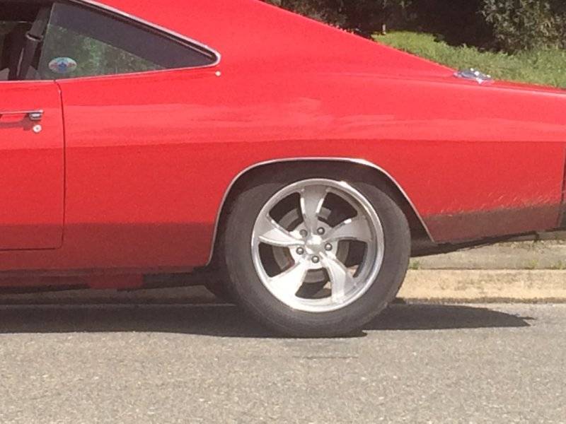

I thought about a 16” rim for the front and a 17” rim for the rear with American Torque Thrust and GoodYear Eagle Sport.
Whatcha think???

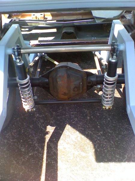

I chose a rear wheel and tire that I wanted and built everything else around those...
I had found a 17x11 with 7 1/2" backspace TT-2 wheel very similar to what you posted.
It looks like a stock 8" wheel from the side but has a chit-ton of back space.
Thought if I could ever find a tire for these that was tall I'd get them...Stumbled across Hoosier 31.50x16.50 17's and bought the rear tires and the rear wheels. (Big Mistake in a way)
The openings in these wheels in 17's are so large you can see everything behind them...The little 10" drum brakes and the 8 3/4 rear looked out of place...
I upgraded to a Dana 60 and 13" Wilwood vented-slotted-drilled rear rotors and Polished Calipers. The rotors have the parking brake shoes inside the rotor hub so since I was going with a stick I would still have a parking brake.
The tires were too wide to retain the inner or outer wheelhouses so everything got cut out and new 2x3 frame rails and a 3 link with coil-overs went back in.
Ultimately the point I want to make is don't get too carried away as it will cost a small fortune...
