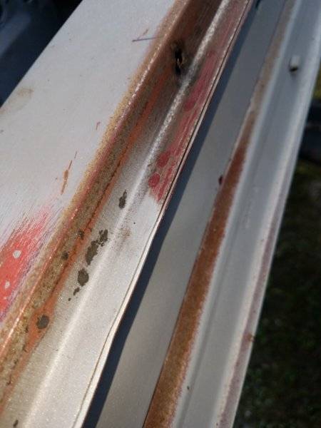

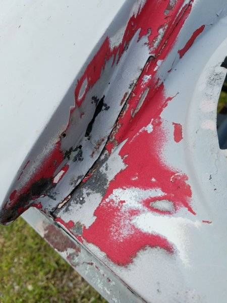

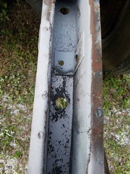

Ok, finally got everything together. Wasted most of the day on yard work so I didn't do much. Just got to see what can be done. I know this isn't a top of the line blaster, but it works. Gotta get some better quality hose clamps though. This is the only abrasive in town so I thought what the heck, I'll try it. Just hit a few spots to see what it would do and I'm pretty happy with it.
