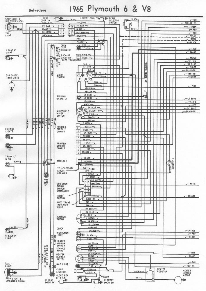

Here is the wiring diagram for the dash and rear lights...

My car is a 1965 Satellite. I found my back up light problem in a bad ground for one of the lights. Still staying on for a few seconds and then going out with a click under the dash then if left alone they come back on. The lights sorta' studders before it goes out. Thanks for the time and answers.
About the console; I found the wiring diagram for a Belevedar, but they don't have a console. I haven't found a diagram for a Satellite with a console. Thanks again!
