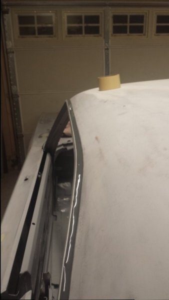

3M self levelling. Very expensive. And be careful with it as it WiLL run downhill. One of my gutters has so much in it at the rear I can't get the trim on. Don't know what I'm going to do about it. Gonna have the bodyman/painter look at it.

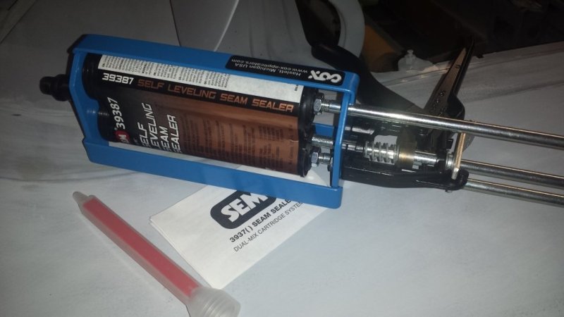

SEM, self leveling seam sealer. It requires a special gun but works great.

It does. I cleaned up the rear with a razor blade after it was set.
@c.moo if you need the gun I can send it to you for the price of shipping. I only used that once.
