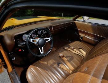

Now, looking at this Charger 71 SE rear bench. It seems the male/female belt configuration continues the same from 60s cars with the male on the fixed belt end? This is what got me confused. I'm sure about 72 and later where all fixed belts are female, but 71 allways got me confused
QSv8Y1xPsNhzDDe-tzQLO_xU4zxDm2Xh-JujXYT-jiQXV4de8ll2up_AXSzBwTmqq8-bgiRTlxoNTFrHdO-SEiS0dEr25ctg.jpg
I don't understand being front and rear diff on the fixed belt terminal!
Even less IF the center front gets the same configuration than rear on this pic with the male on the fixed belt, but outers are reversed!
Is hard to find pics were belts are shown.
Look at this 71 Charger. Is on the way you described, so it seems the front center position fastens opposite to the outers, with the adjustable belt being female like rear bench on previous post ( and 60s cars ). Is a bench car, but I guess the same for buddy seat!

However the brown interior pic I posted previously shows the male end on the left side hip of center, while the female belt on its right side. Reversed form this car on Mecum.
I found a Pilot car Charger 71 R/T with buddy seat ( between Mecum auctions ), but once again belts are not shown clearly.
