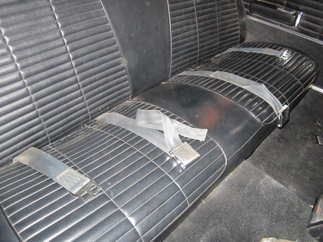

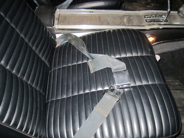

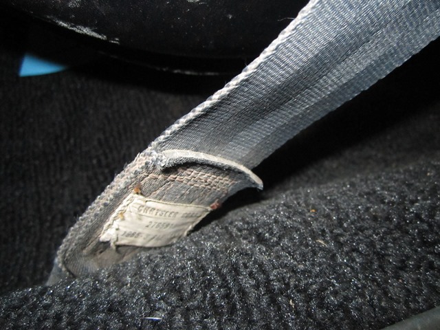

The male end goes on the door side, front and rear. The center belt male end goes on the driver's side, front and rear.
Shown is my '66 Coronet 500, but the belt install should be the same, as far as lap belts go. I can't help you on the shoulder belt question, though.

Installed seat belts on my 69 last winter. if you have the shoulder harness installed the driver side lap belt should have a male and female connector. one for the lap and one for the harness. This means you can use only the lap if you like.
