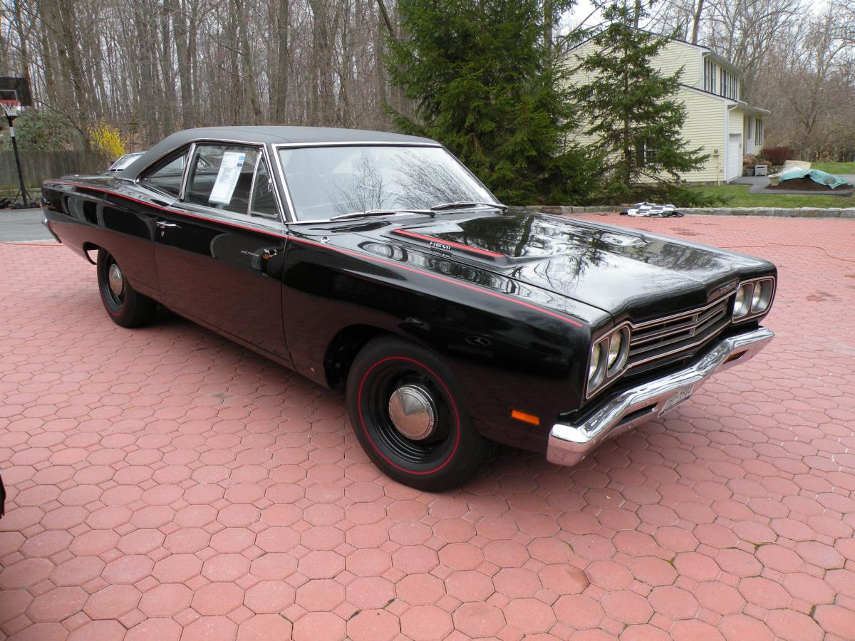

yep that what i did on my 69 hemi Roadrunner. the idiot restoration shop never put them on before attaching the vinyl covers to the seat, i just siliconed them on after i put the holes into the seat cover. been there for 5 years with no issues.
