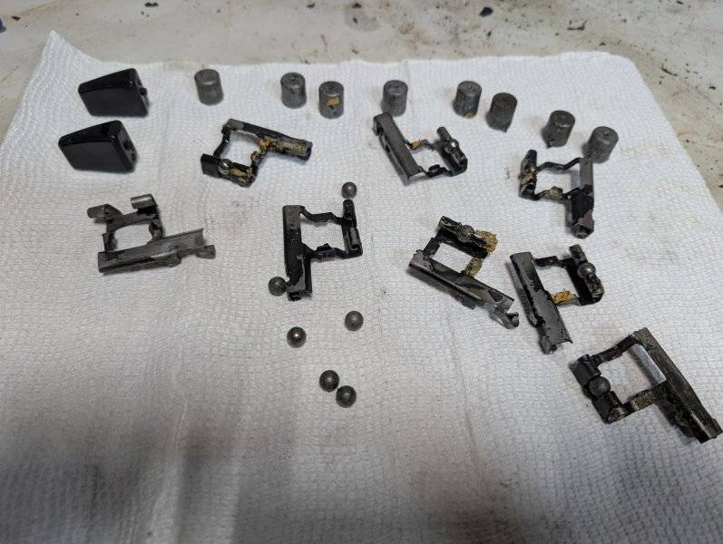

A70Runner, when you say completely apart, did you take the large rivets out to separate the slide and drop the rollers and balls out? Can I ask what you used to reassemble? My 70 Charger tracks are rusted and I'd love to take them apart completely, but not sure what to use to reassemble. When I was cleaning them up, a short fat cylinder, ball and ball "carrier" fell out of one, so I either need to completely disassemble or replace. Any insight (or pics) would be amazing!

There is a way to bend the end of the seat track that allows it to come apart. No need to do anything with the rivets. There is a great YouTube video on how to do it.
Thanks - part 2 is what I needed. They're apart and missing 2 of the roller balls and bent up "carriers". I'm planning on buying 25 of 5/16 ball bearings and straightening the carriers but does anyone make those carriers?
