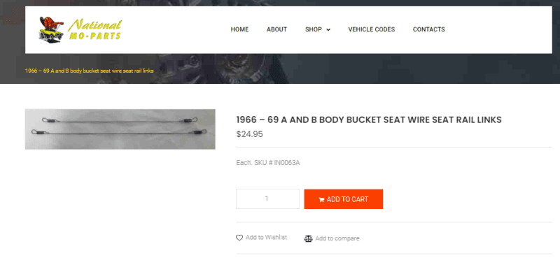

Has anyone ever drilled the stop rivet out in the seat track of a bucket seat and pulled the mechanism apart? I am the proud owner of a really messed up pair of bucket seats. Track to floor mounting studs are gone, wire for seat adj is gone, and the tracks really need some attention. I want to bead blast most of it, but not with the bearings in there. This car was an old race car, maybe, and there are a lot of odd things going on! I have figured out how to replace the seat adj wire. Will figure out a proper length and solder electrical ends onto a small diameter woven wire cable. Not sure, but seats should be '69 Road Runner with head rests.
