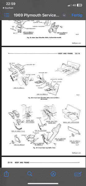

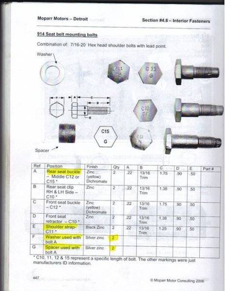

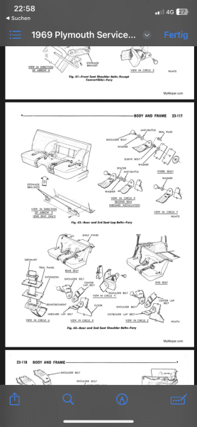

Can anyone with a 1968 B Body convertible tell me which seat belt bolt I need. The bolts have a letter and a number on them C-12, C-11, and C-10. I believe need a total of 8 bolts. As these bolts are different sizes I don't want to put the wrong ones in the wrong position asking for the position of the bolts as well.
I’m not sure if the numbers of the bolts (?). You use ones with a short shank where a single belt bolts up & a longer shank where 2 belts bolt up together (eg for the center belt of the rear seat)
Total of 6 bolts size 7/16 or 7/20“
Rear 4 holes are located at the panel behind the back seat
Front seat 1 hole on each side under the door by the panel and the remaining two in the middle of the transmission hump
8 bolts not 6*
Thanks for the info
The C11 works for most locations. When there are two belts secured at one bolt, such as the front lap and shoulder buckles, the C12 is used.
