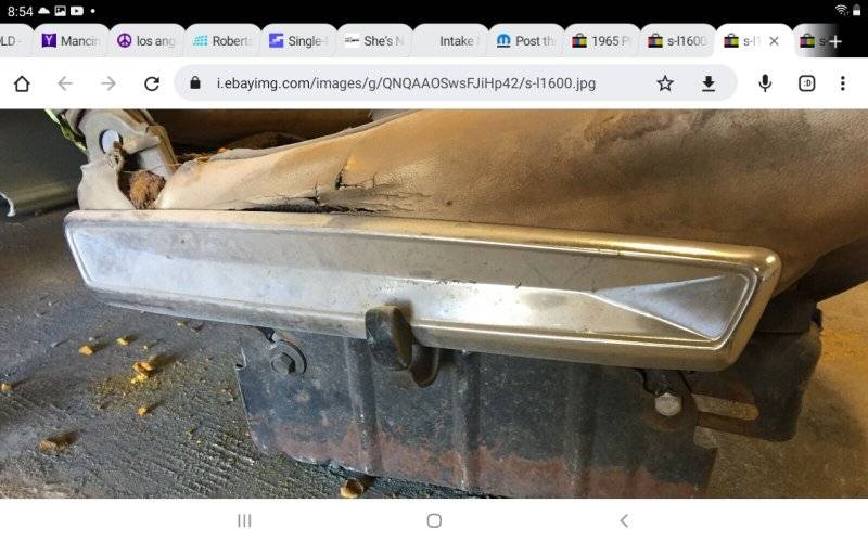

I've got one now but the passenger side only. Looks perfect inside and out, meaning everything is there [ shot ] .
Found the driver's side as a part of a set. Question becomes, is this a match for my 1965 Plymouth Satellite. The listing is: - used pair of 1963 - 1965 Plymouth Fury, Sport Fury, Coronet and Coronet 500 Buckets - showing the door side of the passenger seat. Trim pieces look like they match my single. So, -- Fury turned "C" for 1965. Coronet was "B". This gets shipped, one coast to another. The item is pricy. The interior will be getting restored as a unit. I've seen quite a few variations for that Satellite that were legit. My car's not specified, so is it a match? It should be but I'm guessing.

Just got quotes for shipping and agreed with seller on costs. He'll get more photos tomorrow. Looks like getting the trim and frame for the driver's side should get me ready.

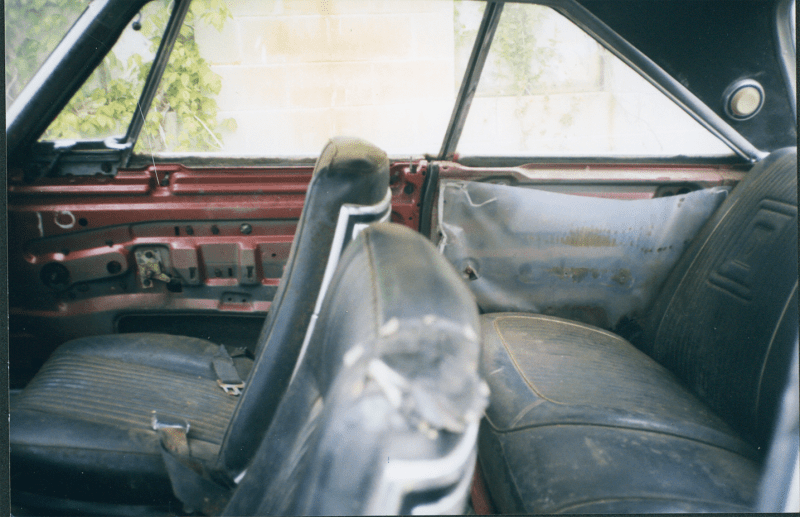

I don't know anything about this panel for the sides of the rear seat section. I am told this backs the panel where the rear arm rest goes. This is what it's like now. I've never had any of these panels for the car. I hope other years have all or some of this. Should match 62',- 64'?
