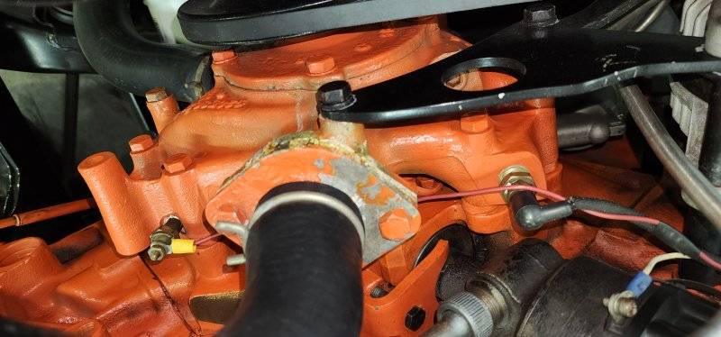

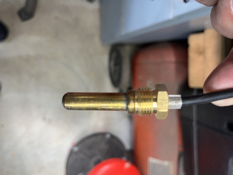

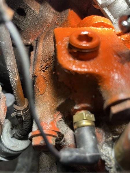

On a 69 SuperBee, 440 motor, presently have electric water temp gage/sender…in the pictures below, the new gage (mechanical) sender is too big for the threaded block hole. But, just above it is a pipe plug, looks like it may fit there. Wanting to know if that plug removed will work for the new mechanical sender? Just hope its deep enough… IMG_4954.jpegIMG_4955.jpeg
Yes. You will need the appropriate bushing ( brass adapter) that should have come with the gauge.
That's where people put them.
Thsnks, i suppose i have to drain radiator?
Yes, like stated above. Two of my cars are using earlier water pump housings, but that's the best place for your auxiliary gauge sender.
