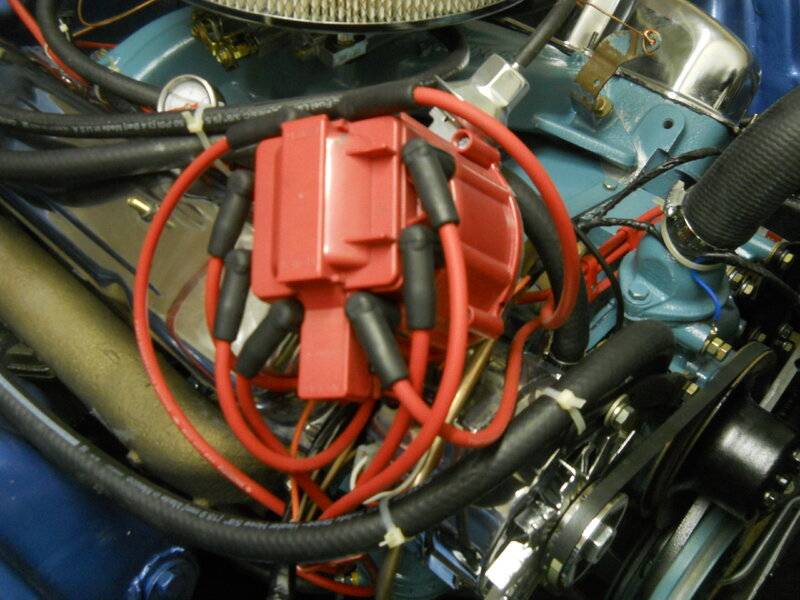

For your pleasure are three GM pieces (dist, alt, ps pump), but wait, even cooler are the bolts on the valve covers to attach a (really) slide hammer! Enjoy.
Well I'm no Bible thumper by any means but there are a couple biblical phrases that are suitable in certain situations. The one that comes to mind here is: "let he who is without sin cast the first stone". That said, show us the junk you're driving !!
I wonder, why would you need a slide hammer to remove valve covers?

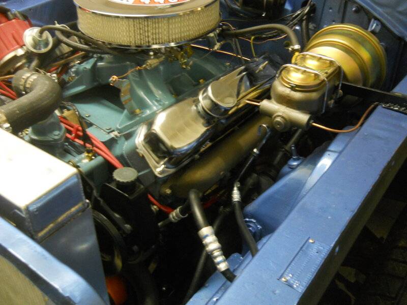

The last time I saw this 66 Coronet 500 convertible, it was in my garage. Thank you, the master cylinder is GM too. The valve cover was glued down after it was beat up to fit the distributor. So the beat up job was done twice.
The thermostat water outlet looks really nice.
(Stay positive people)
What's he got going on with the master cylinder ?
It looks like the power brake setup from "The Right Stuff" disc brake conversion kit?
That looks closer to stock than my engine compartment.

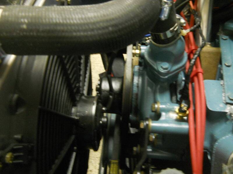

The 505" 440 in the Convertible has the Edelbrock XT TPI type intake manifold, Summit aluminum valve covers, and a Tru-Trac accessory drive system.
Well it all looks fresh and clean, have you driven it and had some fun yet?

It runs real good in the driveway. I need to get some sheet metal on yet.
I'll give it a thumbs up. Bet it bugs the heck out of the numbers matching purists.
Actually looks like well done craftsmanship that works and is not in danger of burning up. Wires tied up and not bare or loose (noticed electrical is the most neglected part of a build).
We all have our strengths and weaknesses. I'm more of a Rat Rodder myself and care more for function than looks and don't have a lot of money.
Also using HEI, but just the module as I did not want to buy a new distributor and re-used stock electronic. Between the HEI and mini starter it does not sound like a Mopar starting, quick touch of the key and starts fast, does not crank long.

Thank you. The whole car was wired from spools and has several relays. Also all soldered old school.
