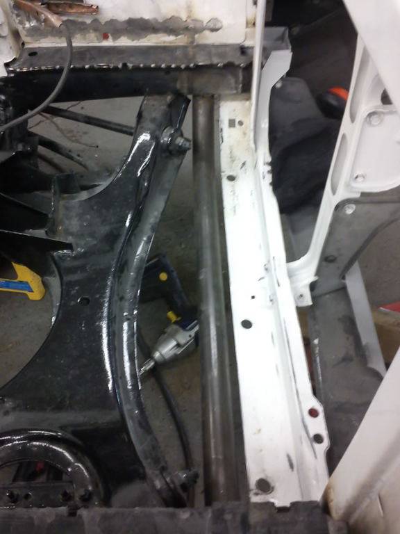

I was just wondering if anyone has tried to make their own inner fender braces? I have seen pics on this site of some from a couple different companies & the tubular ones look rather simple. I have a tubing bender & was thinking of giving it a try.
Just do it!!! Save a few bucks and bend them how you you like....post some pics when your done.
i got a local shop to bend them up for me - I believe they are 1.5" 0.120 wall DOM, made my own plates, I also had him bend me up a lower rad brace as well, I believe the total cost was around $60
I also made my own subframes braces out of 1x3" which i highly reccomend doing yourself
